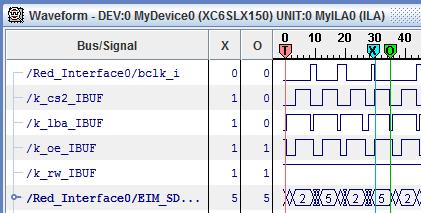

I attach the Chipscope waveforms of three situations at this post. First one shows the signal values of EIM operations between the CPU and FPGA without barrier (relaxed mode). CS2 is the chip selection of the operation. It is an active low signal and when it is low, CPU is allowed to operate an EIM operation. CS2 is at high value between the X and O vertical lines and this value is around 5 EIM clock cycles for relaxed mode.

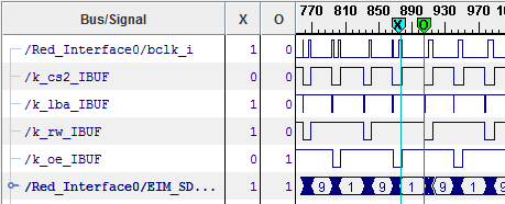

The second image (below) shows the signal values of EIM operations between the CPU and FPGA with barrier (normal mode). The gap between the X and O vertical lines is 25 EIM clock cycles, which means that with the barrier mode, the utilization of EIM bus is around %20. I solved this utilization problem by reading&writing at relaxed mode during the EIM operations and I add only one barrier at the end&beginning of the overall operation. However we could not run CPU in burst mode without SDMA so I should solve this utilization problem in SDMA.

I hope someone know the reason of this gap between the EIM operations in the SDMA. I think the reason is barrier mode operation in SDMA because the second and last image has the same gap values but I do not know how to prove and disable it.
