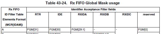

In accordance with 43.9.20 Rx Individual Mask Registers (FLEXCANx_RXIMRn) in IMXRT1064RM v.,,....
For Rx FIFO ID Filter Table Element, refer to Rx FIFO Global Mask Register.
So mask should take the format:

Finally, the global mask was configured incorrectly. It was using the FLEXCAN_RX_FIFO_STD_MASK_TYPE_A macro and should have been using the FLEXCAN_RX_FIFO_EXT_MASK_TYPE_A macro.

My results were that when using Individual mask and Global mask at the same time, Global mask is ignored.
However, I found the following statement in Reference Manual.
FlexCAN also supports an alternate masking scheme with only four mask registers (RXFGMASK, RXMGMASK, RX14MASK, and RX15MASK) for backwards compatibility with legacy applications. This alternate masking scheme is enabled when the IRMQ bit in the MCR register is negated.
As it is mentioned these four mask registers are not enabled when the Individual Rx Masking is enabled. Sorry for the inconvenience this may cause you.
I hope this information is useful.

That comes from the iMXRT1064 Processor Reference Manual Rev 0.1, which was what we were working with when we started development. It should be on the product page somewhere on NXPs website.
