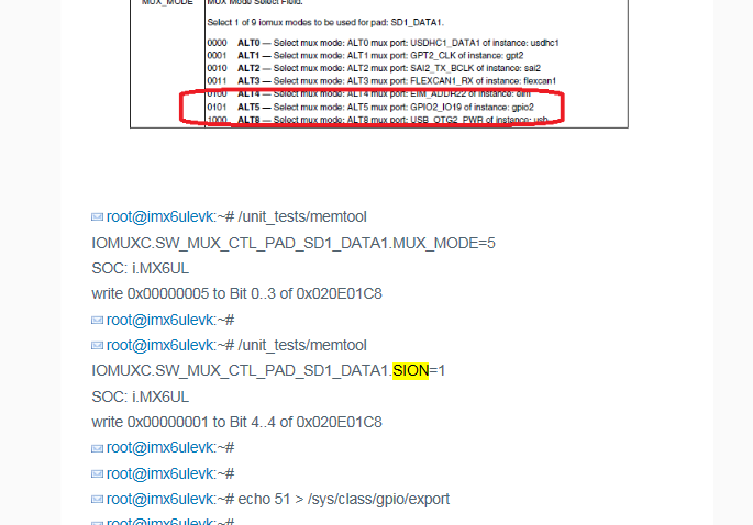

I've got some questions when I test I.mx6q gpio throgh the GPIO-SYSFS feature.
As a picture you can see below,
No matter I input 1 or 0 into gpio199 value , the result is 0.
Pls hlep me ,tks.
*Notice : I've add this pin as gpio into pinctrl_hog in imx6qdl-sabresd.dtsi.

Have you set the SION bit?
Please check the following ticket.
Simple GPIO Example - quandry | NXP Community

I cut from  Simple GPIO Example - quandry  some for you.

BiyongSUN
Please read the Simple GPIO Example - quandry | NXP Community
In the ticket, some one also have quetion exactly the same like you.
And in the ticket, it gives an answer and also test in the i.MX6UL board.
7,191件の閲覧回数
BiyongSUN
Because in the i2c, it set the SION bit. as loopback clock.
When you change the fuction to GPIO. The SION still there.
Please check the SION bit.

浩卢
I've set
#define MX6QDL_PAD_GPIO_1__GPIO1_IO01               0x224 0x5f4 0x000 0x5 0x1
in the file imx6q-pinfunc.h
and set
MX6QDL_PAD_GPIO_1__GPIO1_IO01 0x80000000
in the file imx6qdl-sabresd.dtsi.
when I echo "0 or 1" > /sys/class/gpio/gpio1/value ,I can see the voltage changed 0->3V3 by using the multimeter .
But when I read the value (cat /sys/class/gpio/gpio1/value) , the result is always 0.
