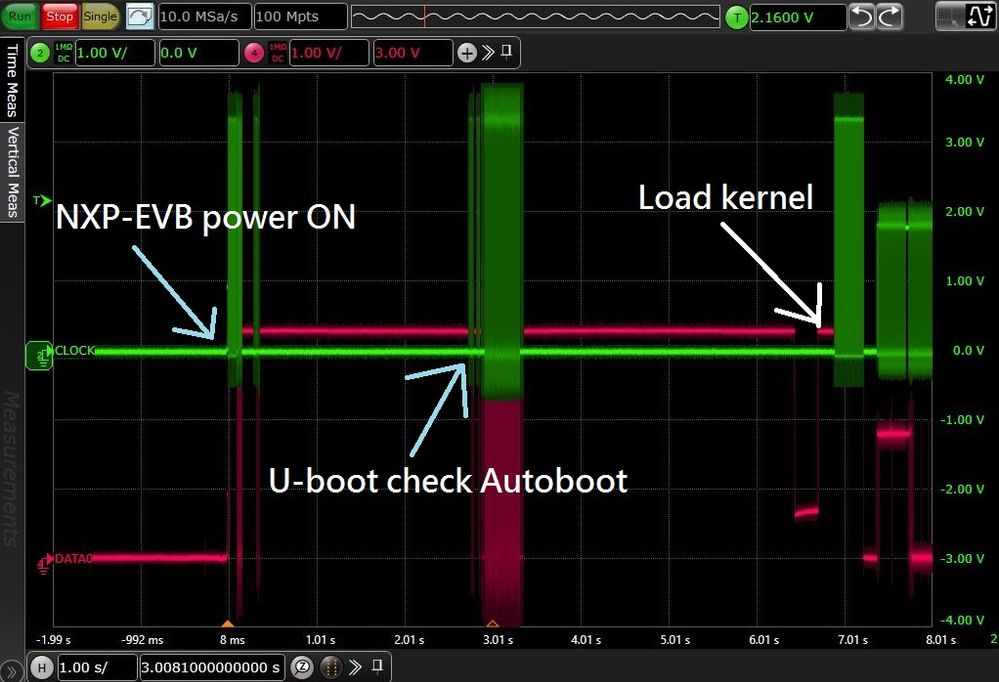

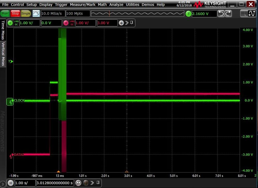

  Can I ask you to do me a favour? I already fill in  LPDDR2 parameters into "imximage.cfg" refer to  "linux/board/freescale/mx7ulp_arm2  imximage_lpddr2.cfg" as you mentioned previously, but now I face another problem is the u-boot stuck and it doesn't show any message at UART port on my_customer board during boot stage.
  Because my_customer board is boot from uSD-Card, so I measured both  "CLK" and "DATA0" signals  on uSD-card to confirm u-boot process is fail.
  I find that "CLK" and "DATA0" signals will continue normal active on NXP-EVB during boot stage (fig 1.) ,but  both these two signal on my_ customer board only active at the beginning during boot stage and then will STOP (fig 2.)
                  fig 1 . Red : DATA0  Green: CKL on  NXP -EVB during boot stage.
                    fig 2 . Red : DATA0  Green: CKL on  MY- Board during boot stage.

 3. According to fig 2. wave form ,could you give me some tips about this case ? Is the DCD table configuration mistake cause this case ?or device tree configuration mistake in u-boot source code?

Hi Sam
example of lpddr2 configuration can be found in
https://source.codeaurora.org/external/imx/uboot-imx/tree/board/freescale/mx7ulp_arm2?h=imx_v2017.03...
plugin.S file is not needed if plugin mode is not used (more description can be found in Boot
Chapter of Reference Manual).
>Does the mx7ulp_evk.h file need to modify?
no
>Is there any files need to modify for porting SDRAM form LPDDR3 change to LPDDR2 ?
except *.cfg file, in  linux/arch/arm/mach-imx  there are specific for memory low power codes
https://source.codeaurora.org/external/imx/linux-imx/tree/arch/arm/mach-imx?h=imx_4.9.88_2.0.0_ga
