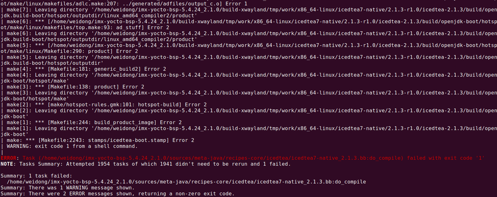

weidong_sun
Hello Prashant,
    Yes, I haven't got a solution yet. I compiled openjdk-8 for Yocto zeus in different environments, but they were all unsuccessful.
B.R,
weidong
5,207 Views

prashant_chopad
Hello Weidong,
Thanks for the reply. I didn't get icedtea7 error.
But I got something different error:
| g++: error: unrecognized command line option ‘-fmacro-prefix-map=/home/ubuntu/code/imx8mm/imx-yocto-bsp/imx8mmevk/tmp/work/aarch64-mx8mm-poky-linux/openjdk-8/242-r0=/usr/src/debug/openjdk-8/242-r0’
| /home/ubuntu/code/imx8mm/imx-yocto-bsp/imx8mmevk/tmp/work/aarch64-mx8mm-poky-linux/openjdk-8/242-r0/jdk8u-shenandoah-aarch64-shenandoah-jdk8u242-b07/hotspot/make/linux/makefiles/adlc.make:228: recipe for target '../generated/adfiles/dfa.o' failed
| make[6]: *** [../generated/adfiles/dfa.o] Error 1
| /home/ubuntu/code/imx8mm/imx-yocto-bsp/imx8mmevk/tmp/work/aarch64-mx8mm-poky-linux/openjdk-8/242-r0/jdk8u-shenandoah-aarch64-shenandoah-jdk8u242-b07/hotspot/make/linux/makefiles/top.make:91: recipe for target 'ad_stuff' failed
| make[5]: *** [ad_stuff] Error 2
| /home/ubuntu/code/imx8mm/imx-yocto-bsp/imx8mmevk/tmp/work/aarch64-mx8mm-poky-linux/openjdk-8/242-r0/jdk8u-shenandoah-aarch64-shenandoah-jdk8u242-b07/hotspot/make/linux/Makefile:284: recipe for target 'product' failed
| make[4]: *** [product] Error 2
| Makefile:230: recipe for target 'generic_build2' failed
| make[3]: *** [generic_build2] Error 2
| Makefile:177: recipe for target 'product' failed
| make[2]: *** [product] Error 2
| HotspotWrapper.gmk:44: recipe for target '/home/ubuntu/code/imx8mm/imx-yocto-bsp/imx8mmevk/tmp/work/aarch64-mx8mm-poky-linux/openjdk-8/242-r0/build/hotspot/_hotspot.timestamp' failed
| make[1]: *** [/home/ubuntu/code/imx8mm/imx-yocto-bsp/imx8mmevk/tmp/work/aarch64-mx8mm-poky-linux/openjdk-8/242-r0/build/hotspot/_hotspot.timestamp] Error 2
| /home/ubuntu/code/imx8mm/imx-yocto-bsp/imx8mmevk/tmp/work/aarch64-mx8mm-poky-linux/openjdk-8/242-r0/jdk8u-shenandoah-aarch64-shenandoah-jdk8u242-b07//make/Main.gmk:109: recipe for target 'hotspot-only' failed
| make: *** [hotspot-only] Error 2
| WARNING: exit code 1 from a shell command.
ERROR: Task (/home/ubuntu/code/imx8mm/imx-yocto-bsp/sources/meta-java/recipes-core/openjdk/openjdk-8_242.bb:do_compile) failed with exit code '1'
NOTE: Tasks Summary: Attempted 1709 tasks of which 1708 didn't need to be rerun and 1 failed.
Summary: 1 task failed:
Summary: There were 2 ERROR messages shown, returning a non-zero exit code.
On the last task I got the error.
Is there a way to overcome it?
Prashant

weidong_sun
Hello Prashant,
In order to compile openjdk-8 in Yocto zeus, I tested 18.04 LTS, 19.04 LTS, 20.04 LTS, but all failed. I have encountered the problem you encountered. The reason is that your 18.04 LTS gcc/g++ compiler version is too low to recognize the -fmacro-prefix-map parameter.
weidong
5,206 Views
