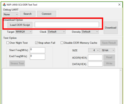

i.MX8/i.MX8X/i.MX8DXL has ddr stress test tool. It is a window UI program.
In some cases, i.MX devices is security closed. Need signed image to run.
Such as unit fail field return analyze, switch new ddr part on existing board.

How do you include the DDR Stress Test Script (e.g. MX8QuadXPlus_DualXPlus_B0_DDR3L_RPA_v19.ds) ?
On the GUI you have the option "Load DDR Script" but there is no option to include a .ds script on the PDF instructions. Could you please help? Thanks
The scfw inside the ddr stress tool is build by DDR_CON=ddr_stress_test_parser.
That makes you can load different configuration dynamically.
BTW, the scfw inside the ddr stress tool should be replaced by the current version being used, which has instructions in the guide.
The "flash_ddrstress rule" of imx-mkimage is using the same normal scfw as you make a normal flash.bin.
The configuration of ddr is in the scfw, but it could not dynamically be changed.
Because ddr4/lpddr4 is using auto cal/training. The initial parameters are the same.
All the part from each ddr vendor, which follows the ddr   JEDEC spec.
For example, all the ddr vendor copies the JESD209-4A.
The only different is size, but we can send command to change the size.
