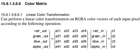

The Matrix is consist of two parts:
You can program any value into register of A11 to A44 and C1 to C4, Matrix will applied on input RGB data, then output RGB data will changed as you want. In this way, we can change the display brightness/contrast/saturation.
The Matrix entry from A11 to A44, their register format is same as below:
Each register entry of A11 to A44 , total 13 bit, bit 12 is symbol bit , bit 11 and bit 10 is integer bit, bit 9 to bit 0 is floating point bit.

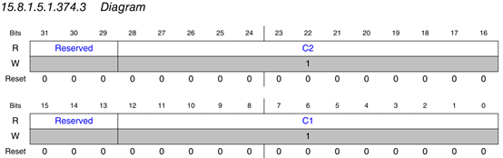

The Matrix entry from C1 to C4, their format is same as below:
Each register entry of C1 to C4, total 13 bit, bit 12 is symbol bit, others are integer bit.

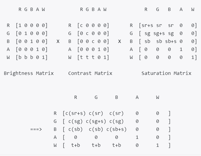

Now let us choose the matrix that will be used for adjust brightness/contrast/saturation.
See this link  https://docs.rainmeter.net/tips/colormatrix-guide/
So we can set matrix as below to change brightness/contrast/saturation
  A11=c(sr+s)   A12=c(sg)    A13=c(sb)
  A21=c(sb)     A22=c(sg+s)  A23=c(sb)
  A31=c(sr)     A32=c(sg)    A33=c(sb+s)
  C1=C2=C3=t+b
b as brightness , range[-1.0, 1.0], zero means no change , >0 will increases brightness, <0 will reduce brightness.
c as contrast, range [0,2.0) , default is 1.0 , >1.0 is increase , <1.0 is reduce.
s is saturation, range [0,1.0], default is 1.0.
Other matrix entry is related to alpha, in this doc not change it, just keep them as zero.
Note here sr,sb,sg value will depend on lumR/ lumG/ lumB constant value you choose, this value may depend on different color standard.
