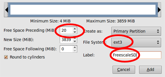

Create ext3 partition
With the SD card reader, create an ext3 partition. You can use gparted, a graphical partition manager tool. Launch gparted:
 $ sudo gparted
Create a new ext3 partition, with 20MB of offset:
