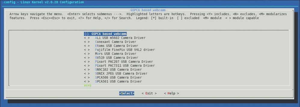

                        <*> GSPCA Based WebCams -->
From this point, you need to choose your specific driver. If you don't know, you can select all of those options as a built-in module "<*>" that will work.

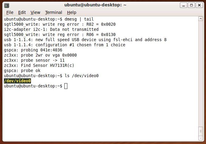

Connect your USB camera to the USB Host port on i.MX 51 EVK board and then type "dmesg", and also check if there is a video0 device using:
ubuntu@ubuntu-desktop:~$ ls /dev/video0
/dev/video0

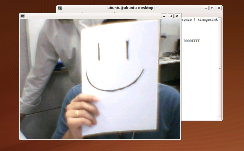

In order to test your USB camera using Gstreamer plugin, use the following command line to perform it:
ubuntu@ubuntu-desktop:~$ gst-launch-0.10 v4l2src ! ffmpegcolorspace ! ximagesink
and the results:
