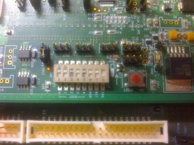

2 - Some hardware configurations (switches) must be done to flash the board.
  Set SW2 switch as below: Switch SW2 -> 11111

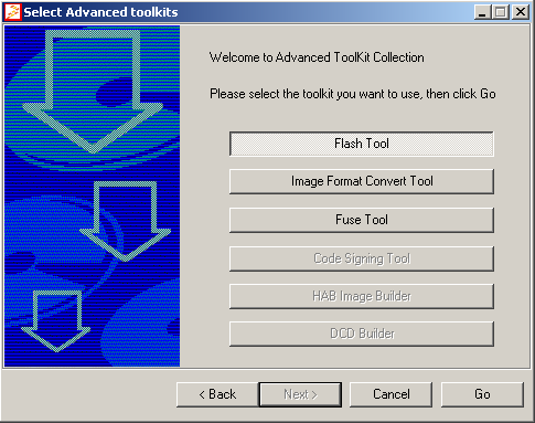

3 - Run ATK going to Start -> Programs -> AdvancedToolKit -> AdvancedToolKit
  Set the options:
  Device memory -> DDR; Custom Initial File -> (keep it unmarked)
  Communication Channel -> Serial Port (Usually COM1)
4 - Click on Flash Tools to erase, program or dump the the flash memory and click GO

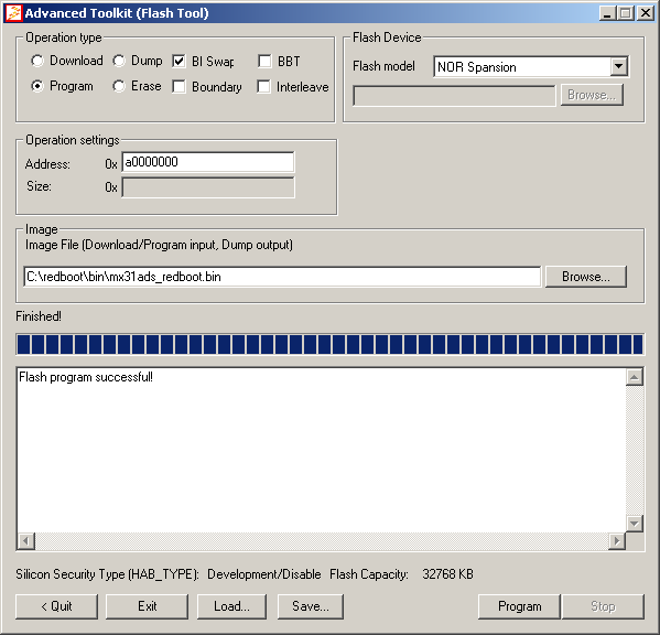

The next step is to program the bootloader image into the board's Flash following the steps below.
1 - Select the parameters as shown in the figure below and press Program.
The bootloader binary image file can be found into your Board Support Package
Set Program, NOR Spansion
2 - Add it on Image File field and press Program.
3 - Close ATK, turn off the board and set switch back as shown in the picture below.
Switch SW2 -> 11010
