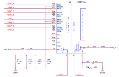

1. Hardware design
KSZ9031
Power Rail of KSZ9031
[Comment]
1. VDDIO: KSZ9031 supports 1.8V or 3.3V IO, here we use 1.8V
2. Phy address: 0x07
3. Reset Pin: Using GPIO1_IO07 Pad of CPU
4. 125MHz OUTPUT: not used, left unconnected.
