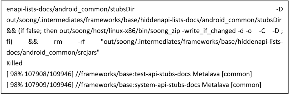

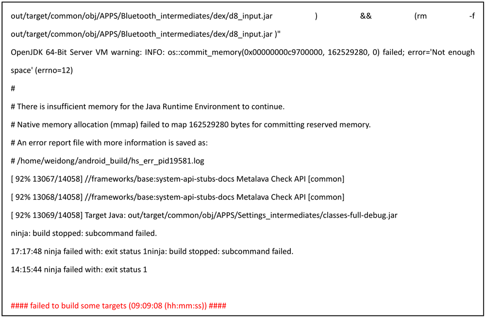

   Since this version of Android BSP requires high memory capacity when compiling, if the
memory configuration of the virtual machine is incorrect, it is very likely to cause the compilation
to fail. The following is a list of variable tests for user reference:

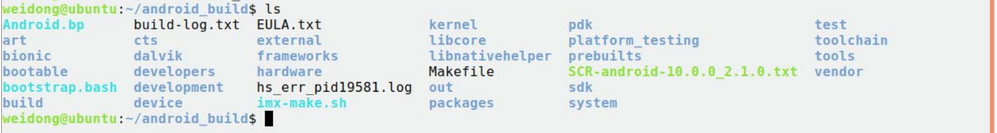

# cd android_build
# export AARCH64_GCC_CROSS_COMPILE=/opt/gcc-arm-8.3-2019.03-x86_64-aarch64-linux-gnu/bin/aarch64-linux-gnu-
# source build/envsetup.sh
# lunch evk_8mp-userdebug
# ./imx-make.sh -j2 2>&1 | tee build-log.txt

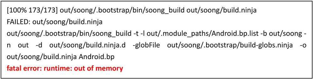

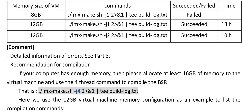

1. Allocating 8GB Memory For VMware Player
# ./imx-make.sh -j1 2>&1 | tee build-log.txt
2. Allocating 12GB Memory For VMware Player
# ./imx-make.sh -j4 2>&1 | tee build-log.txt
# ./imx-make.sh -j4 2>&1 | tee build-log.txt (Run it again)
      So if we use 4 thread to compile BSP, command for compilation will have to be run for 3 times.
