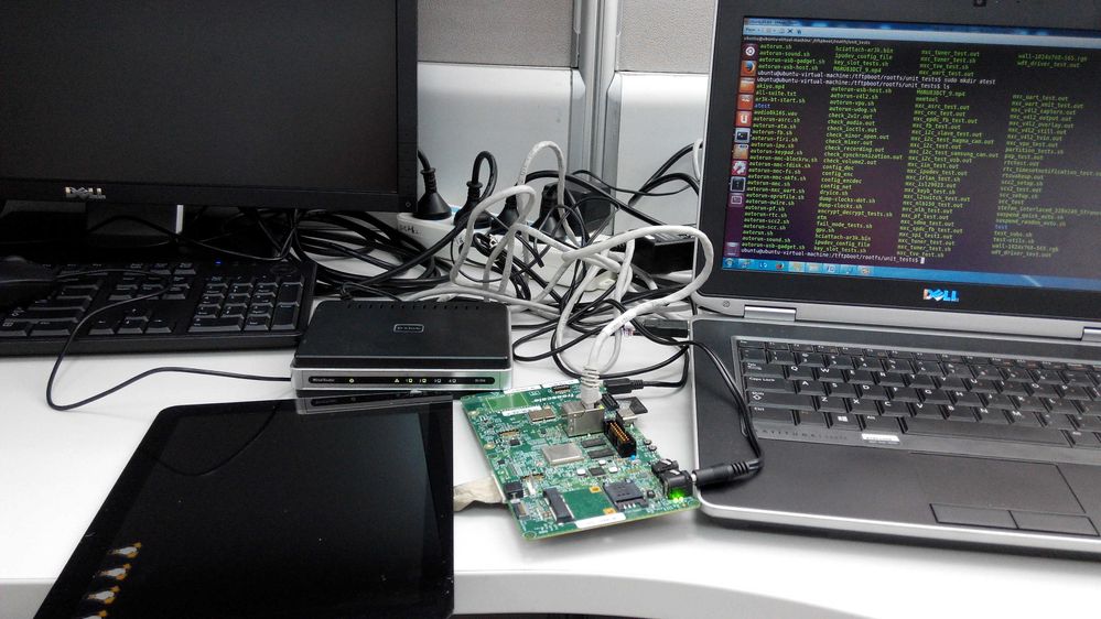

The  platform is as follow:

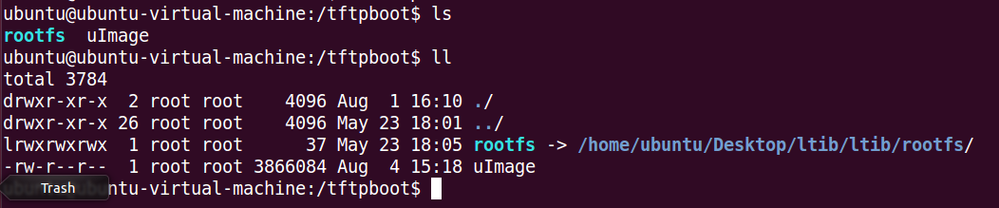

2 - Create symbolic link to ltib/rootfs
$sudo ln -s <ltib instalation folder>/rootfs /tftpboot/rootfs

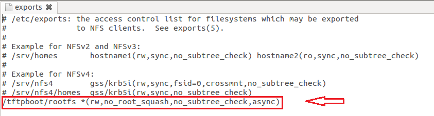

3 - Setup exports typing:
$sudo gedit /etc/exports
and add the following line:
/tftpboot/rootfs/ *(rw,no_root_squash,no_subtree_check,async)
4 - Restart the NFS server:
$sudo /etc/init.d/nfs-kernel-server restart
Now the host is ready to use NFS

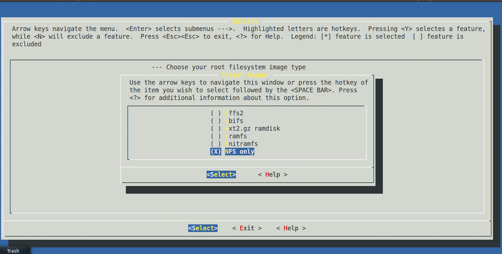

Setting Target Linux Image to use NFS
1. Run LTIB configuration by typing:
$cd <ltib instalation folder>
$./ltib -c
2. On first page menu, go to "Target Image Generation -> Options"
3. Select the option NFS only and exit LTIB configuration to compile with the new configuration.
4. LTIB should start new compiling and create a new Linux image on /<ltib instalation folder>/rootfs/boot/uImage
5. Copy the created image on /<ltib instalation folder>/rootfs/boot/uImage to /tftpboot/uImage
6. The system is ready to run with NFS. The root file system on target will be located on host on /<ltib instalation folder>/rootfs/

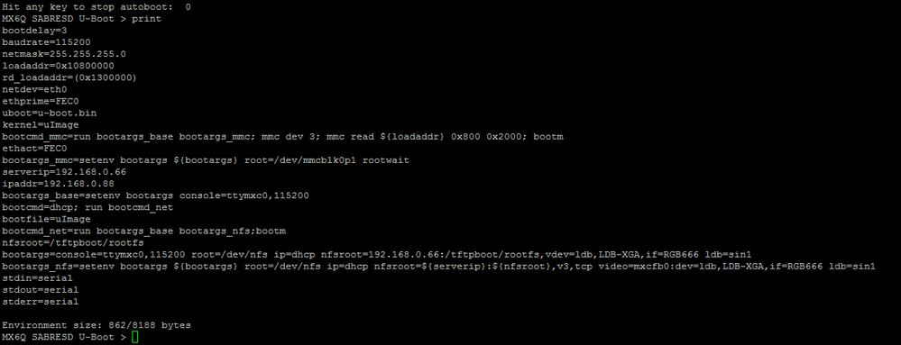

3 Setting the u-boot command line
(1)Download the u-boot to the target board fist according to the section 1 (2) Download the u-boot to the target board. Then give the power to the board, boot up board, u-boot boot up.
(2)Configuration the Network
Configure the Network and IP , to make the target board and the host machine IP are in the local area network of Router.
(3)Set the u-boot command line
As follow is my setting for you to refer to :

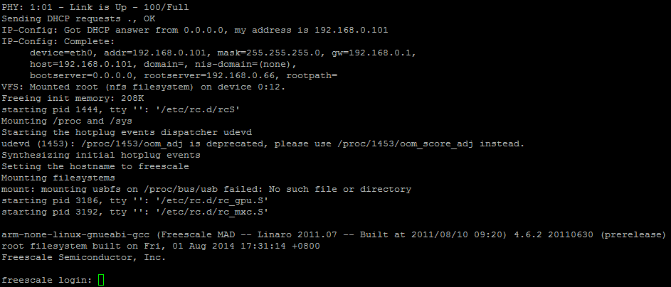

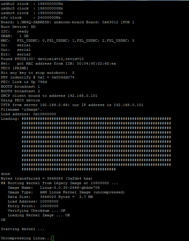

4 Boot up the board
Running the “run bootcmd” after setting the u-boot parameters then boot up the kernel and file system. We can see that the board download the uImage by the TFTP from host machine, then boot up the kernel and finally mount the NFS in the kernel. As follows is the details:
Downloading the uImage success and boot up kernel:
Input root and access the system.

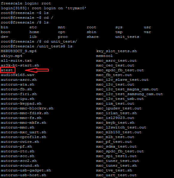

Test: Create a new file in the host machine directory, you can see in the next picture:
Then open the target board, in the terminal go to the same directory  in the unit_test we can see the same name. So as we can see in the above operation we can see it is very convenient and fast use the NFS. It will help save time and speed the development time.
