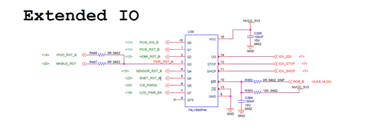

adding customized code in u-boot head file
refer to the customized board schematic as below:
This board use eth2 as ethernet port, the code mx7dsabresd.h(path: yocto-L4.9.88_2.0/build-x11/tmp/work/imx7dsabresd-poky-linux-gnueabi/u-boot-imx/2017.03-r0/git/include/configs)

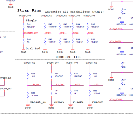

Change the source code as below, add two macro definition and change the PHY address according to the schematic:

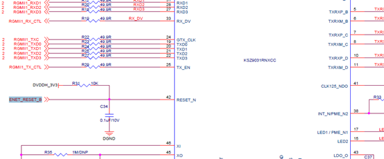

  2.        Focus on the setup_fec fuction
Imx7d Sabresd board uses gpio_spi 5 as reset pin so the source code as below:
ret = gpio_lookup_name("gpio_spi@0_5", NULL, NULL, &gpio)
               if (ret) {
              printf("GPIO: 'gpio_spi@0_5' not found\n");
The customized board uses GPIO1_IO03 as reset pin, so the source code was changed to :
imx_iomux_v3_setup_pad(MX7D_PAD_GPIO1_IO03__GPIO1_IO3 | MUX_PAD_CTRL(NO_PAD_CTRL));
ret = gpio_request(IMX_GPIO_NR(1, 3), "enet_phy_rst");
gpio_direction_output(IMX_GPIO_NR(1, 3), 0);
       mdelay(20);
       gpio_direction_output(IMX_GPIO_NR(1, 3), 1);
      udelay(100);
  1.       Focus on the function board_phy_config fuction
Use this function to set the phy rx, tx data pad skew and clock pad skew, for ksz9031, can refer to the UDOO board, then change the setting source code as below:
/* control data pad skew - devaddr = 0x02, register = 0x04 */
       ksz9031_phy_extended_write(phydev, 0x02,
                               MII_KSZ9031_EXT_RGMII_CTRL_SIG_SKEW,
                               MII_KSZ9031_MOD_DATA_NO_POST_INC, 0x0000);
       /* rx data pad skew - devaddr = 0x02, register = 0x05 */
                               MII_KSZ9031_EXT_RGMII_RX_DATA_SKEW,
       /* tx data pad skew - devaddr = 0x02, register = 0x05 */
                               MII_KSZ9031_EXT_RGMII_TX_DATA_SKEW,
       /* gtx and rx clock pad skew - devaddr = 0x02, register = 0x08 */
                               MII_KSZ9031_EXT_RGMII_CLOCK_SKEW,
                               MII_KSZ9031_MOD_DATA_NO_POST_INC, 0x03FF);
