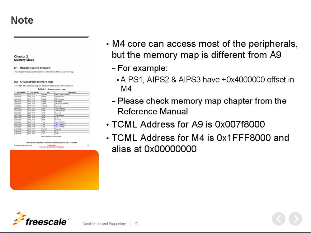

Nice document Yuri. Do you know why the RM states that the 0x007f8000 area is reserved?
It would be awesome if a further document you explain the RDC and CSU in detail.
Alejandro, hi !
  Appears, I also cannot find any official documents
(except examples) about  0x007f8000 address  mapping.
Yuri.
Got it! Thanks Yuri.
Alejandro
Hi Alejandro
attached part of 6SX_Cortex-M4_Development.pptx presentation
which can be found on below link
SoloX starting M4 & stopping A9 & lowest power with just M4 running
p.12 shows 0x007f8000 address  mapping for A9 TCML
Igor
Thanks a lot Igor!
I can't access the pptx presentation, clicking on the link reports "Access to this place or content is restricted. If you think this is a mistake, please contact your administrator or the person who directed you here."
suggest to ask local FAE to give you access to that document.
~igor
