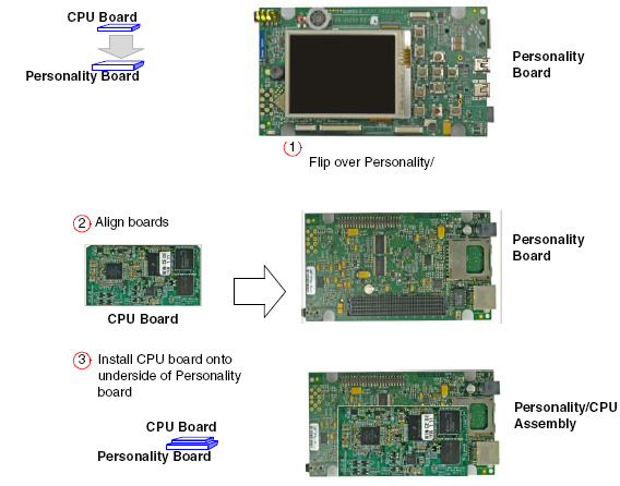

Build the Demonstration Platform
To make a demonstration platform, the CPU board is directly connected to the Personality board using the 500-pin connector that is keyed to avoid misconnections, so there is only one way to connect the CPU board to the Personality board.
The Debug board is not used.
![Build_imx31-pdk_demonstration_step1.png Build_imx31-pdk_demonstration_step1.png](/t5/image/serverpage/image-id/37790iFAC83BD3829B4A88/image-size/large?v=v2&px=999)

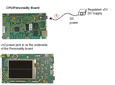

Connect platform to PC
![Connect_imx31-pdk_demonstration.png Connect_imx31-pdk_demonstration.png](/t5/image/serverpage/image-id/37789i54BCAB858B8A51CC/image-size/large?v=v2&px=999)
