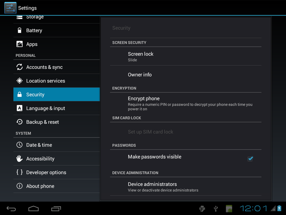

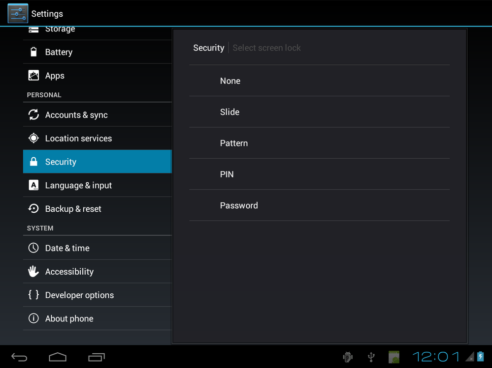

To use this feature, go to settings and security as below:
Encrypted phones need to set the numeric PIN, so click Screen lock to set password:
Choose PIN:

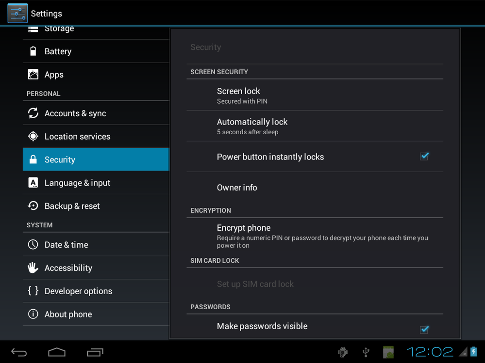

After setting up PIN code, the Screen lock is showed "Secured with PIN" as below:

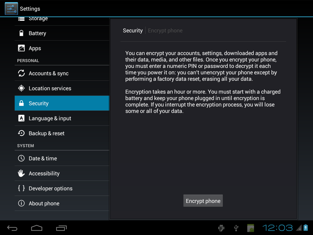

We can then click Encrypt phone to start:
Note the words on this page, it needs start with a charged battery and the charger needs to be on.

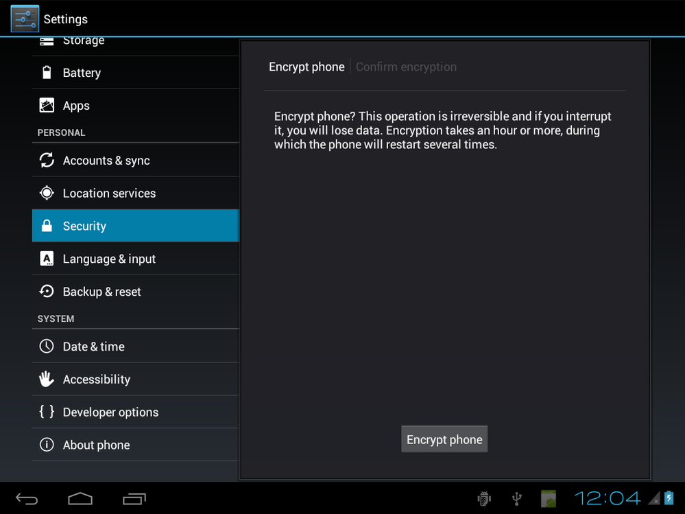

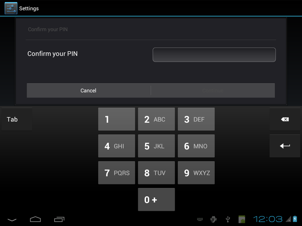

Click Encrypt phone button and it will ask PIN code setup before:
Enter the PIN code and then has the confirmed page:

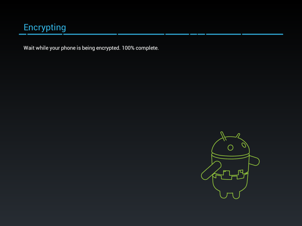

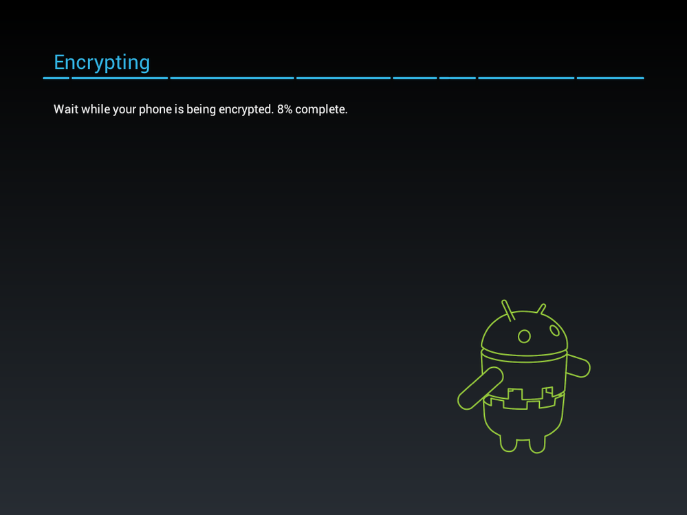

Click Encrypt phone, it will reset framework and starting to encrypt:
After running 100%:
It then reset the device. When it boots, it will ask you enter the PIN to enter system.

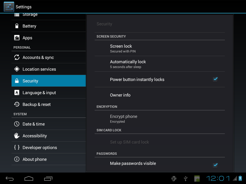

Check Setting -> Security again:
The status showed Encrypted under Encrypt phone.
