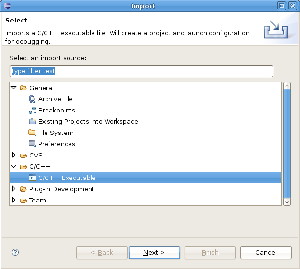

Open-up Eclipse and choose the C/C++ perspective. We will import the HelloWorld executable built by LTIB. Go to the menu File -> Import You will see the “Import” screen.
Select “C/C++ Executable” option.
Hit the “Next” button.
Eclipse automaticaly creates a new project when whe use the “Import” option.
In the next screen, select the “Search Directory” option and hit the “Browse” button.
