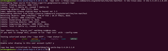

# mkdir imx-yocto-bsp-5.4.24-2.1.0
# cd imx-yocto-bsp-5.4.24-2.1.0
# repo init -u https://source.codeaurora.org/external/imx/imx-manifest -b imx-linux-zeus -m imx-5.4.24-2.1.0.xml
# cd .repo/manifests
# gedit imx-5.4.24-2.1.0.xml

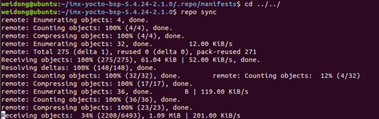

# cd ~/ imx-yocto-bsp-5.4.24-2.1.0
# repo sync

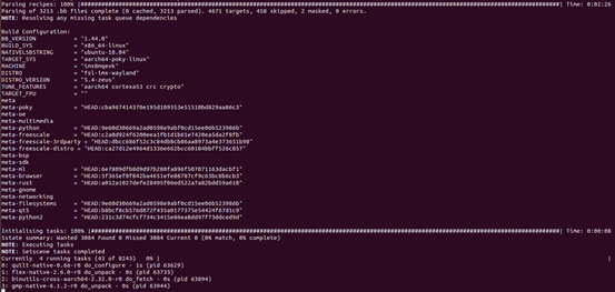

# DISTRO=fsl-imx-wayland MACHINE=imx8mqevk source imx-setup-release.sh -b build-wayland
         If users want to use chromium, do it like below, otherwise omit the step.
       Add CORE_IMAGE_EXTRA_INSTALL += "chromium-ozone-wayland" to local.conf
       And use 8 thread to compile BSP
# gedit ./conf/local.conf
BB_NUMBER_THREADS =”4”
PARALLEL_MAKE =”-j 4”
         Save it and exit.
[comment]
         If your ubuntu has 8GB DDR, BB_NUMBER_THREADS can be set to “2”, PARALLEL_MAKE can be set to “-j 2”.

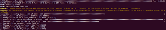

# bitbake chromium-ozone-wayland -c fetch

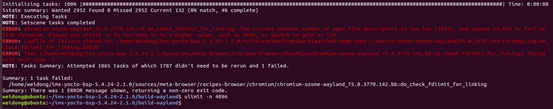

# bitbake imx-image-full
Use ulimit -n 4096 to solve the issue. Then continue.

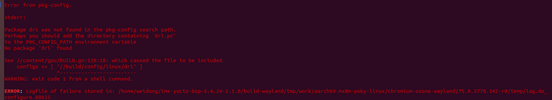

chromium compilation error:

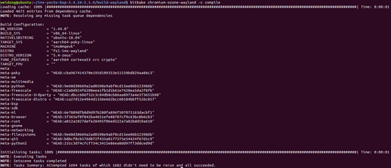

         Compile chromium-ozone-wayland separately.
# bitbake chromium-ozone-wayland -c cleansstate
# bitbake chromium-ozone-wayland -c compile
         Use the command to solve the problem.
# gedit ../sources/meta-imx/meta-sdk/dynamic-layers/browser-layer/recipes-browser/chromium/chromium-ozone-wayland_%.bbappend
DEPENDS += "\
        libxkbcommon \
        virtual/egl \
        wayland \
        wayland-native \
         mesa         \
  Add mesa to DEPENDS
         Save and exit.
         Continue to compile it.
         done, continue to compile full image
