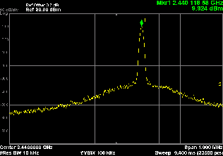

     Now we are tunning the frequency error for bluetooth boards with KW45 solution.

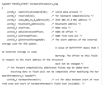

     We get  two ways for tuning Frequency error.
     1. The first way is changing the value of internal capacitance, named Xtaltrim value in hardwareParameters in HCI_black box Firmwave.
  2. The second way is adding EXternal capacitance in Oscillator.
    We wanna ask you The difference between the two ways for Frequency tuning. If we wanna get better RF performence in Frequency accuracy test, which one is better for us.
    And here is our Default Frequency accuracy=118.5Khz, out of the limit(-20, 20)ppm. Would you mind give us some ideas about it, Thank you very much.

     Sorry, I did not describe my problem Clearly.
     Our problem is our dut is performening worst result in Frequency error, and how can tuning the Frenquency, and let us get correct Frenquency.
     For example, now we control dut to send a signal in 2440 Mhz for KW45 bluetooth funtion. But now we get the signal is 2440.11858Mhz, it is out of  the limit.
     How can we tunning to get more corrcect Frenqency?
