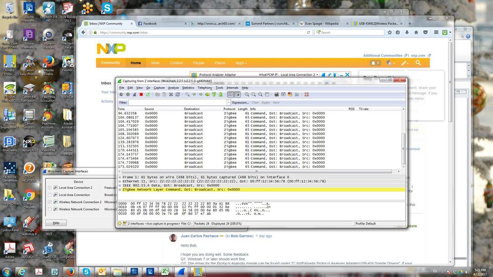

    After a couple of hours of fiddling this afternoon, I finally got some capture data via the KW41Z Dongle.  I never got any Bluetooth data so I fired up a Wink Controller because I knew that it would emit ZigBee signals.  I captured the Wink ZigBee broadcast signals below but, as you can see, I got NO RSSI power data which is the sole reason I'm trying to used the KW41Z in conjunction with Wireshark.   I had added the RSSI column properly as far as I know.  I even added the "TX rate" column to see if the KW41Z would generate that data.  No luck!!
   QUESTION: What am I missing?   What should I check for at this point?
Cheers,
Bob G.

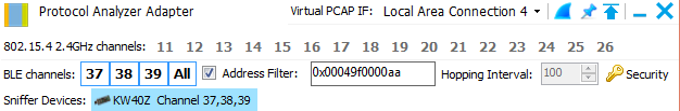

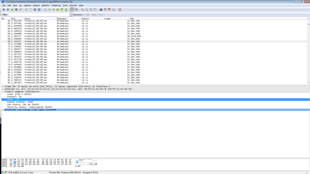

Hi Bob,
Did you select the BLE Channels?
You can add address filter an look for your specific device.
Then you will see the advertisement information and if you look into the Kinetis Adapter Information, you will find the RSSI value.

bobgarrow
Mario,
   Thanks for the comments.
Re. Selection of BLE Channels:  I did select all three channels.   My "Protocol Analyzer Adapter" screen looked just like the one you attached.
Note: As a test of BLE capture, with the Adapter set up as you suggest, I used my Verizon LG Cell Phone in "Discovery Mode" to generate Bluetooth packets but none were captured.   I have no idea what channels those packets were on.  If they are not on either 37,38, or 39, the Adapter would not see them.  QUESTION: Is that possible???  I actually don't know how many Bluetooth channels there are.   Notably, my NXP Adapter did capture a single stray BLE packet that was "mal-formed" so I have one data point suggesting that my NXP Adapter does work with BLE.
Re. Address Filter: That would be a help if the Adapter ever captures some Bluetooth packets.   I added the RSSI column to my Wireshark screen so that I could see every RSSI value that the Adapter picked up.   Re. your screenshot.   I don't see an RSSI value anywhere on the screenshot that you attached.  Pls tell me where to look for it.
FYI...Thus far, I've not been able to capture any RSSI values even for a ZigBee capture that managed to make work..   I was able to get the Adapter working for ZigBee using a Wink controller to emit the ZigBee packets but that does not include the RSSI data which I did not get even though I had the RSSI column correctly added.   That RSSI data is the whole point of my testing effort so, once I solve the problem of receiving packets, I'll have to solve the RSSI column problem as well.

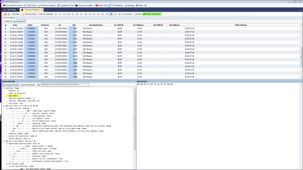

mario_castaneda
Hi Bob,
You can't see the RSSI value and the TX power. As you can see the Wireshark is not be able to show that values for BLE or 802.15.4. The Wireshark is showing the RSSI value for the 802.11.
The PC is assigning a virtual COM for the KW41Z Dongle, so the PC create an interface and the wireshark is detecting the dongle as an Ethernet connection.
The NXP Test Tool can show the LQI value instead the RSSI, so the Wireshark can't display the values that you are looking for.
But if you are looking a sniffer with the RSSI values, you can use the SW Ubiqua Protocl Analyser
Hope it helps.
Mario

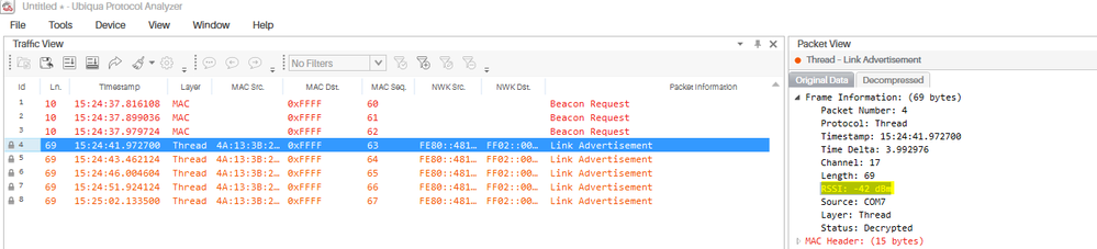

bobgarrow
Mario,
    Ubiqua worked pretty well for Zigbee and I was able to capture good RSSI data.  Thanks again!

bobgarrow
Mario,
    I've got Ubiqua capturing Zigbee packets!!    I can see the RSSI value for one packet at a time.   QUESTION:  Is it possible with Ubiqua to add an RSSI colume to the Traffic View?
    THANKS again :smileyhappy:
