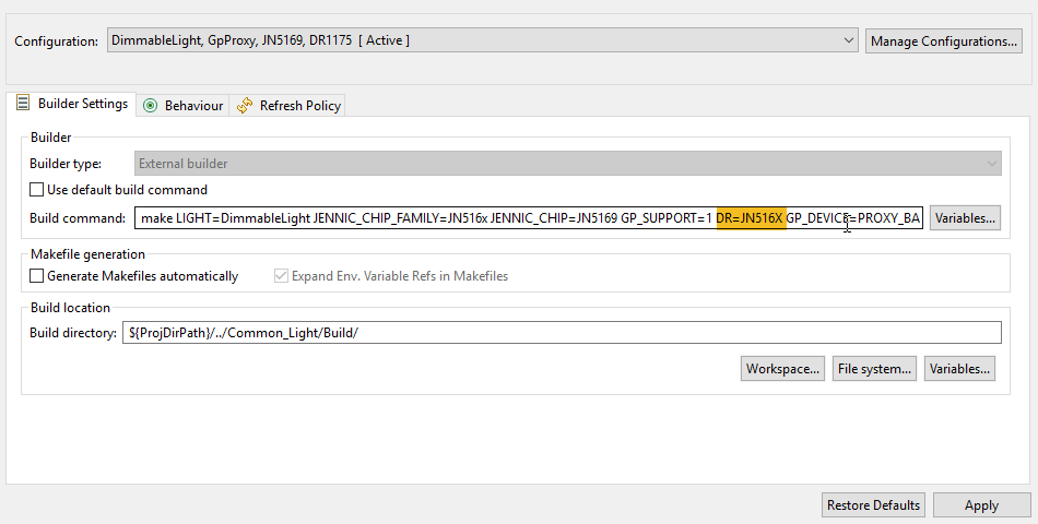

Hi Mario,
No problem English is not my main language so I don't expect my messages are put together all that well.
Yes that is what i want to achieve. But even without creating a custom driverbulb implementation and just using the provided DriverBulb_JN156X.c example I just cant get it to work.
My process:
  1. download the JN-AN-1218
  2. Import it in to BeyondStudio
  3. Edit Makefile
    • JENNIC_CHIP=JN5168
    • DR=JN516X
  4. Compile Error: DimmableLight/Build/irq_JN516x.o:(.text+0x4c): undefined reference to `vISR_SystemController
After looking through the other DriverBulb examples if found that some just define the function but with no actual code.
  • Implement the vISR_SystemController() {}
  • Compile Succes
  • Program the JN5168 module
  • Run: Bus Error
I aslo tried:
  3. Edit Makefile
    • DR=WS2812
  4. Compile Error: gave a hole list of compile errors. but did not further  investigate that because I have no plans on using WS2812 LEDs
3,335 Views

youpko
Hi Mario,
After going trough the JN-AN-1218 it seemed that defining DR=JN516x was the way to build the DriverBulb_JN516x.c
Because changing the DR define you can select different Evaluation Kits so I assumed that setting DR=JN516X in there it would build the image for a bare JN5168/JN5169 module.
I guess I assumed wrong?
I read through JN-RD-6038 but that described how to make your own modules based on the JN516x chips, but that is not for my application as I using the JN5168-001-M00 module.
I also read though the thread you linked. I did what you described there to make my configuration for the JN5168.

Hi Youp,
I had been running some test.
You could compile with the DriverBulb_JN516X.c
Please see the steps below.
Set the JN516X in the build properties
In the Makefile
#DR = DR1175
DR = JN516X
The file DriverBulb_JN516X.c
