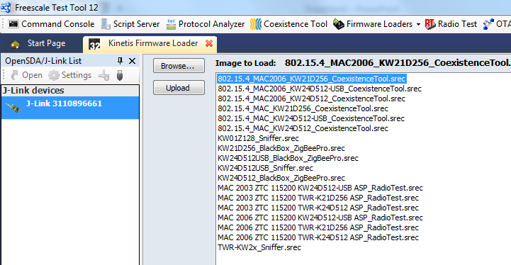

1) How to download the sniffer image file onto KW01.
     a) Connect KW01 to PC using the mini-usb cable
     b) Connect the J-Link to the PC

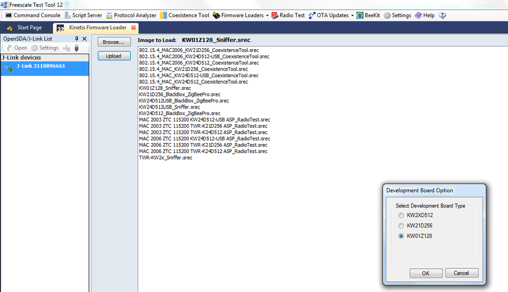

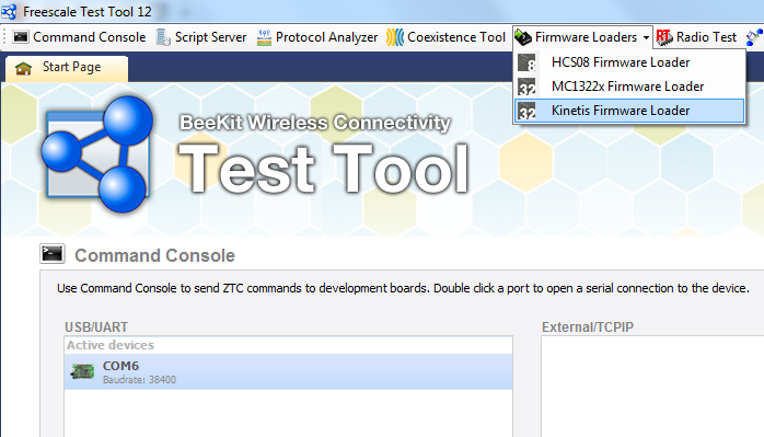

     c) Open Test Tool 12.2 and go to the Firmware Loaders tab
     d) Select Kinetis Firmware Loader. A new tab will pop-up.
     e) J-Link will appear under the J-Link devices tab.
     f) Select the KW01Z128_Sniffer.srec file and press the upload button.
    g) From the Development Board Option menu select KW01Z128.
     h) Follow the on-screen instruction and unplug the board. Then plug it back in.
     i) Close the Kinetis Firmware Loader tab and open the Protocol Analyzer Tab

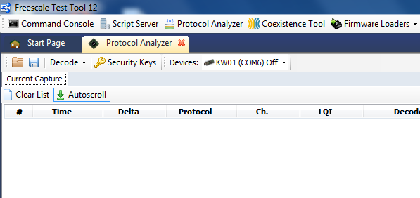

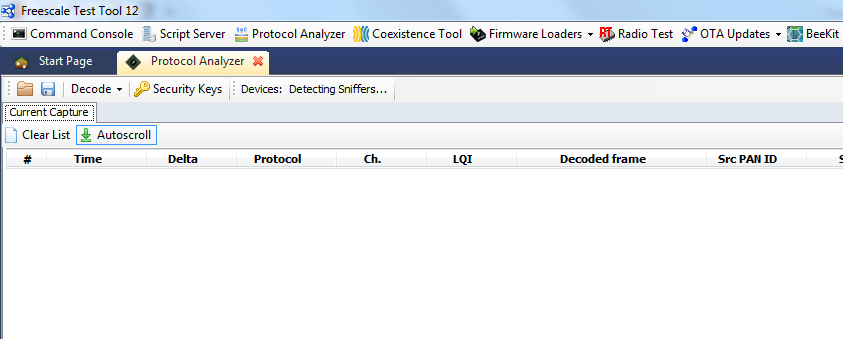

    a) The Protocol Analyzer should automatically detect the KW01 sniffer. If not, close the tab, unplug the board, plug it back and re-open the tab. If this doesn’t work, try restarting Test Tool.

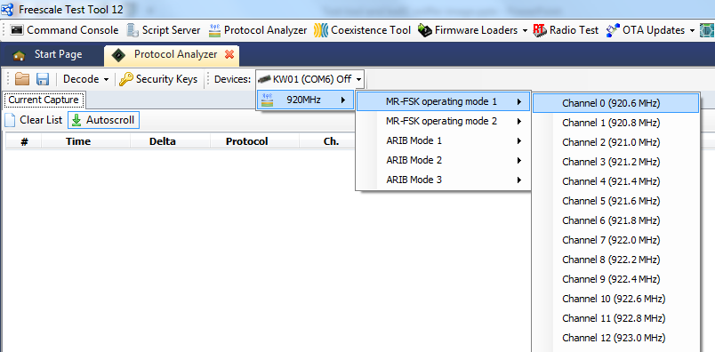

    b) To start “sniffing” the desired channel, click the arrow down button from Devices: KW01 (COMx) Off and select the desired mode and channel.
    c) The tab will change to ON meaning that KW01 will "sniff" on the specified channel. To select another channel, click the tab again and it will switch back to Off. Then select a new channel.

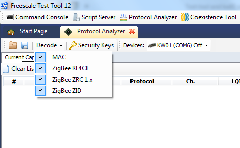

     d) Regarding other configurations, please note that you can specify what decoding will be applied to the received data.
