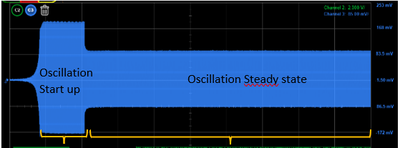

Here below is an oscillation example to explain better the phenomenon:

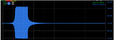

At start up, the configuration is set internally by the hardware in order to be sure to start the oscillation, the load capacitor is 0pF. After this time, it is the steady state and the load capacitor from the internal capabank is taken into account.
If load capacitor is not set correctly with the right oscillator gain, the oscillation will not be maintained after the start up.

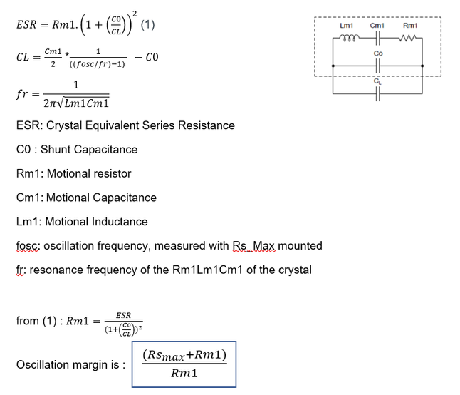

The oscillation margin is able to be calculated as follows:
The oscillation margin calculation is based on the motional resistor Rm by formula below :
Example: for the EVK board’s 32kHz crystal (NX2012SE)
ESR   80000,0 ohm
Rm1   79978,2 ohm
Lm1    3900 H
Cm1   6,00E-15 F
C0      1,70E-12 F
CL      1,25E-08 F
fr        32901,2 Hz
fosc    32771 Hz
Series Resistor Rsmax      7,50E+05 Ohm
Oscillation Margin   10,3

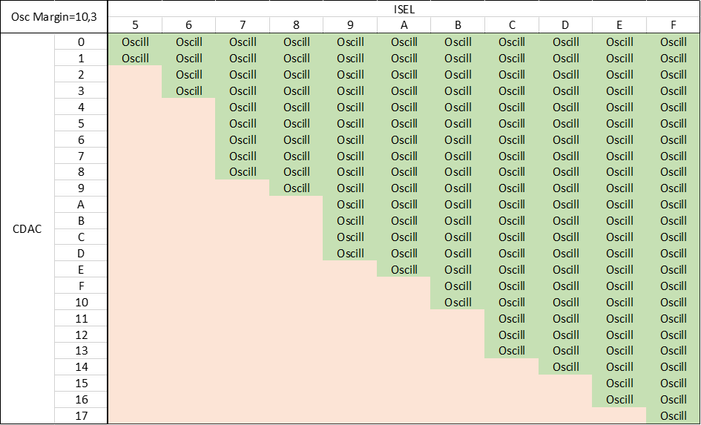

Example: for the oscillation margin 10 (Series Resistor Rsmax = 560W)
The CDAC/ISEL area where the oscillation starts and propagates in the internal blocks is defined (‘oscill’) in the table below.

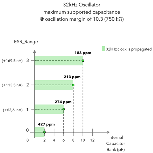

For an oscillation margin at 10 for instance, the Capacitor value from the databank (CapSel) is limited (green area) as shown in the graph below:

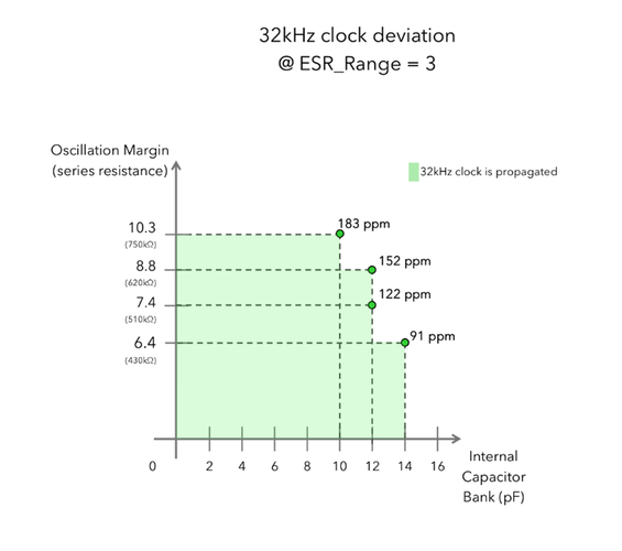

Example:  for an oscillation margin at 6.4, if the load cap is set at 14pF and the ESR_Range to 3, the 32kHz frequency accuracy will be around 91ppm. From this point, the oscillation margin can be enlarged to 10.3 by decreasing the load cap to 10pF but the accuracy will be degraded (183ppm).
For an Oscillation margin at 10, the graph below is showing the ESR_Range versus the load cap. The possible load cap variation range (in green) is larger when the ESR_Range increases:
Example: at oscillation margin 10.3, the clock accuracy can be improved from 213ppm to 183ppm by setting the ESR_range 2 to an ESR_Range 3 but the current consumption will be increased to 169.5nA.
An other important point is that for a given ESR_Range value, getting higher the load cap is much more increasing the current than in the example above.
Remark: Under a high oscillation margin condition, the crystal voltage will be smaller.
