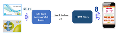

4.1 Hardware preparation
Hardware required:
- NCF3320 Antenna v1.0 board as an NFC transceiver;
- FRDM-KW36 board as host MCU, used to load and run the Bluetooth Low Energy Stack and NFC application logic;
The communication between the boards will be via the SPI communication using the following pin configuration:
Master board (FRDM-KW36)         Connects to            Slave board (NCF3320 Antenna v1.0)
PTB0  (J2-pin10)                                      -                    IRQ
PTB1  (J2-pin9)                                         -                    Reset
PTA16 (J2-pin1 - SPI1_Sout)                   -                    MOSI
PTA17 (J1-pin5 - SPI1_Sin)                     -                    MISO
PTA18 (J1-pin7 - SPI1_SCK)                   -                    SCK
PTA19 (J2-pin3 - SPI1_CS)                     -                    CS
GND   (J3-pin7)                                        -                    GND

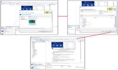

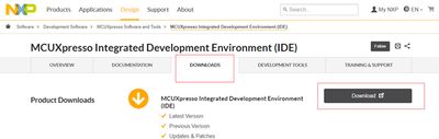

Install MCUXpresso IDE (for this example we are using v10.2.0 build 759)
- Go to MCUXpresso-IDE webpage and download the latest version of IDE: www.nxp.com/products/: MCUXpresso-IDE.
- Install the IDE;

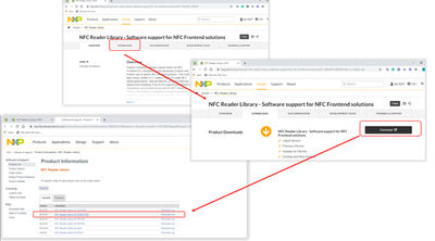

Get the latest NFC Reader Library release (for this example we are using v5.21.00)
- Go to NXP NFC Reader Library webpage (www.nxp.com/pages/:NFC-READER-LIBRARY)
- Go to the Downloads tab and click on the download button
- Download the NFC Reader Library for Kinetis K82F package:

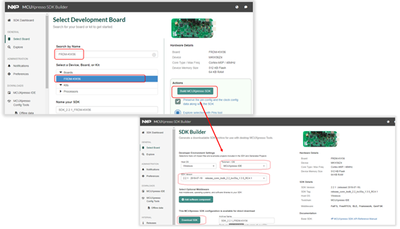

Generate a downloadable SDK package for FRDM-KW36 board (SDK_2.2.1_FRDM-KW36)
- Navigate to https://mcuxpresso.nxp.com/en/select and select FRDM-KW36 board;
- Select Build MCUXpresso SDK.
- As toolchain, please make sure that the MCUXpresso IDE is selected.
- Use Download SDK button to start downloading SDK package:

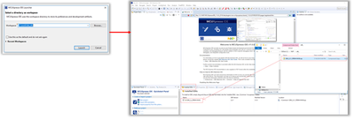

Create MCUXpresso workspace
- Open MCUXpresso IDE and create a workspace;
- Drag and drop the SDK_2.2.1_FRDM-KW36 into the installed SDKs tab of the MCUXpresso IDE;
- Import Wireless_Uart Example to the current workspace:

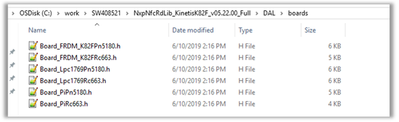

- unzip the NFC Reader Library and navigate to boards folder:

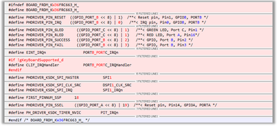

- Create an equivalent file for FRDM-KW36 (Board_FRDM_KW36FRc663.h) by setting the right configuration for GPIOs and handlers;
- Below are the differences required for FRDM-KW36 board in comparation with a FRDM-K82F board:
- Add the FRMD-KW36 to …DAL\cfg\BoardSelection.h file:
#ifdef PHDRIVER_FRDM_KW36FRC663_BOARD
#include <Board_FRDM_KW36FRc663.h>
#endif

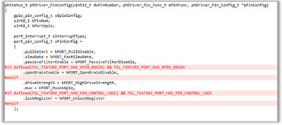

- In KinetisSDK folder, update the following dependencies:
o PIT Driver IRQ name:
o Open drain and pin lock configuration:
- phDriver_KinetisSDK.c:
- phbalReg_KinetisSpi.c:

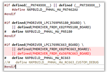

- add PHDRIVER_FRDM_KW36FRC663_BOARD define to …\NxpNfcRdLib\types\ph_NxpBuild_Platform.h file to enable the right NFC transceiver:

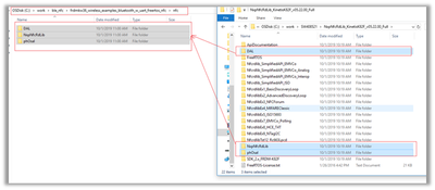

- On the wireless_uart project location create an “nfc” folder:
- Copy from modified NFC Reader Library the DAL, NxpNfcRdLib and phOsal folders:

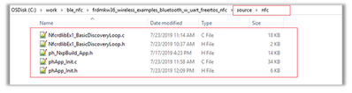

- On the wireless_uart project location, “source” folder create a new “nfc” subfolder to integrate the BasicDiscovery loop files:
- Some changes will be required on the BasicDiscoveryLoop files:

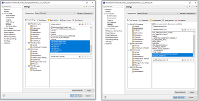

- Update the linker information (Project Properties -> C/C++ Build -> Settings) and preprocessor defines (Project Properties -> C/C++ Build -> Preprocessor):
