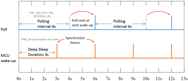

As an example, let's say we configure the polling interval to 4000ms and the deep sleep duration to 3000ms. The MCU will wake up every 3000ms but the poll message will be sent every 2 deep sleep timeouts = 6000ms because the timers are synchronized when the MCU wakes up. The following figure shows the behavior of this example.

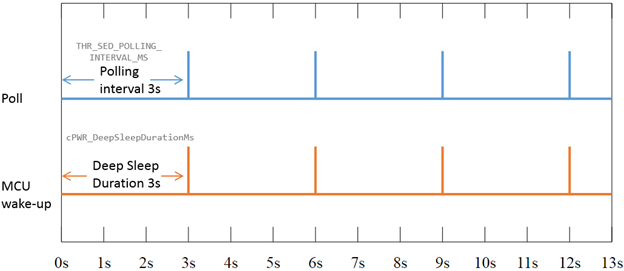

It is recommended that the polling interval is the same as the deep sleep duration, so the MCU doesn't wake up unnecessarily. The following figure shows this behavior.
