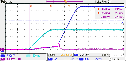

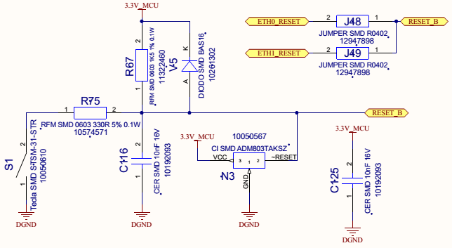

sandrobastos
hi jamesbone,
follow the screenshots of 3.3V, 1.2V (ddr) and reset, signals; also follow the PMIC circuit.
note that, the reset time is approximately 280ms.
Keep in mind that my 1V2 ballast transistor is fed by 1.5V (not by 3.3V)
robsontenedini‌

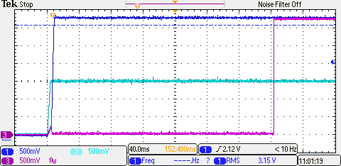

sandrobastos
hi James,
you can see in the attached pictures that, 8ms after reset rises (dark blue), you see some activity on qspi clk (purple), i believe at this moment, vybrid is reading the SFLASH_CONFIGURATION_PARAM in order to correctly set up the qspi...
the qspi clock is 60MHz
after about ~16ms from this activity, you can see the ddr cke (light blue) goes high and the qspi clk comes back to activity, in order to read the code from qspi and write it to ddr.
actually, if i connect the i-jet to the frozen board, using the 'attach to running target' feature, i can see the code correctly written in the ddr (0x80000000), but it does not start...
the second picture was caught pressing the reset button; it's identical to the first one (power on reset), but in this case, the system starts correctly...
thank you,

jamesbone
Hello Sandro,
Base on the information and screenshots that you provide, our Applications team came into the following findings:
1. Why is there so much noise on the RESET_B trace? +/- 200 mV. That's almost 25% ripple, if it is coming from the power supply.  Check up on that.
2. The pull up resistor on the DDR_RESET trace (R50). Depopulate this. It is violating the requirements of the JEDEC standards for power up sequencing. At first glance, this might be the biggest contributing problem.
3. From the DCD file, the IOMUX settings for pins DDR_CS_D_15 through DDR_CS_D_0 are wrong. (0x4004827C - 0x400482B8). Bit 16 is DDR_INPUT. It controls whether the input of the pad uses a CMOS gate or a differential gate (with VREF as the reference point). For best operations, DDR_INPUT for the data pads should be selected to 1 = Differential input mode. Setting the clock trace to Differential input mode does nothing, since the clock is never an input. So leaving the clock trace as DDR_INPUT = 1 is okay.
4. There are numberous registers that are set incorrectly in the DCD file. I am attaching the current DCD file used by our BSP team as a reference (vybrid_10.c). I am also attaching a register programming aid for Vybrid for DDR3. The register programming aid is a handy reference.
