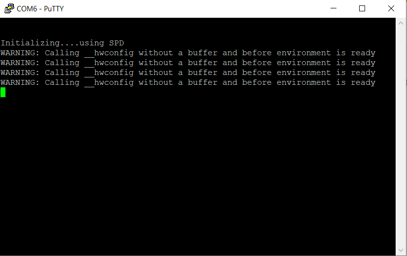

yusufalti333
On T1042 Demo board, I did exactly the same steps mentioned in this question, and board stucked at this screen. Do you have any suggestion about this error. I used SDK V2.0 - 1703 yocto generated 'u-boot-sdcard-2016.09-fslgit+r0.bin' and 'fsl_fman_ucode_t1040_r1.1_106_4_18.bin'.
I double checked switch settings, thet are correct.
3,990 Views
