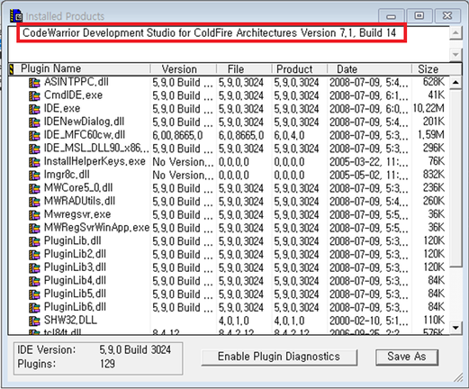

- IDE : CodeWarrior Development Studio for ColdFire Architectures Version 7.1
  . LSE_C.W_02-1_CW.Ver_CW.for.ColdFire.V7.1.pngLSE_C.W_02-1_CW.Ver_CW.for.ColdFire.V7.1.png

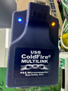

- Debugger : P&E Microcomputer, USB ColdFire Multilink
  . Debugger
    : LSE_C.W_02-3_used.Debugger_USB.ColdFire.Multilink.pngLSE_C.W_02-3_used.Debugger_USB.ColdFire.Multilink.png

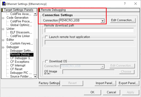

  . Debugger Configuration, in CW
    : LSE_C.W_02-2_Debugger.Setting_in.CW.pngLSE_C.W_02-2_Debugger.Setting_in.CW.png

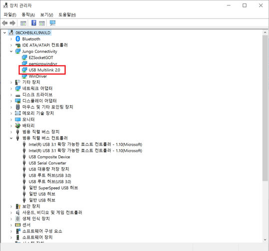

  . detected Debugger, in Device Manager
    : LSE_C.W_02-4_detected.USB.ColdFire.Multilink_in.Device.Manager.pngLSE_C.W_02-4_detected.USB.ColdFire.Multilink_in.Device.Manager.png

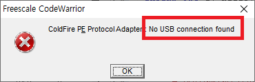

> Debugger Connection Error
- CW / Debug / Connect
- Error Message
  . LSE_C.W_02-5_Error.Message_for.Debug.Connect.pngLSE_C.W_02-5_Error.Message_for.Debug.Connect.png

Hi Eric,
About how to program firmware to MCF52234 chip, there are two options:
1. Using P&E PROG-HL-CFZ software with P&E Multilink Universal debugger
P&E provides standalone Flash programming software for ColdFire chip, which works with WIN 10 system.
More detailed info, please refer below link:
 https://www.pemicro.com/products/product_viewDetails.cfm?product_id=15320181&productTab=1
2. Using CodeWarrior for MCU provided [Flash Programmer] tool with P&E Multilink Universal debugger tool:
Customer need to create a MCF52234 project, then call [Flash Programmer]  provided [Flash File to Target] tool.
The File can select customer would like programmed image.
Wish it helps.

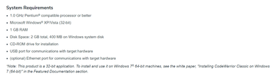

Hui_Ma
Hi Eric,
The CW for CF V7.1 is Classic CodeWarrior IDE with below Windows system supported:
WIN10 is not supported
Customer could try with CodeWarrior for MCUs (Eclipse IDE), which supports WIN 10. The latest version is V11.1
Another issue is that P&E USB-ML-CFE debugger is discontinued, replaced with P&E Multilink Debugger tool. The P&E USB-ML-CFE could not provide driver for WIN10 OS.
