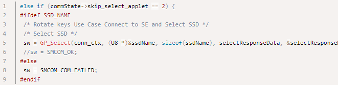

Hi all,
I am running the sample code from SE05X Rotate PlatformSCP Keys Demo on the SE050 ARD board (OEFID = 6). I am using simw-top version 2.14.
The APDU request from the sample code returns 0x6A80 (invalid policy?)
An object is only created if the attached policy is valid and, if the policy validation fails, the error code 0x6A80 is returned as response to the object creation command. AFAICS the sample code doesnt configure any policy. Is there anything else that needs to be done? anything that is missing?
many thanks in advance
Jorge

Kan_Li
Hello Jorge,
The example se05x_RotatePlatformSCP03Keys has the following definition:
which triggers SSD selection instead of IoT Applet selection to rotate the keys:
You may also follow this in your application.
Kan

jorge_ramirez
Hi Kan
Right, I had found the exact same thing on my application so you were spot
on.
https://github.com/ldts/optee_os/commit/4988bd70ebd6a081dba7f57f5090fddeaba2b066#diff-ac8f07735297dd...
Sorry that I forgot to update the thread once I had the issue fixed.
thanks
Jorge
