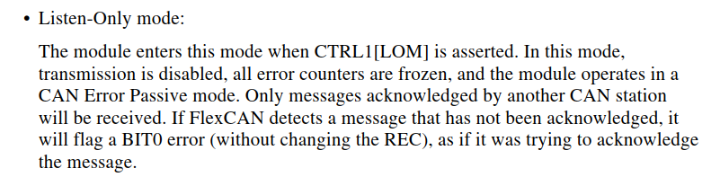

   I use S32K148,  for flexcan module,I want to Switch off transmit path, because i can not find the right way to do it, so i choose set flexcan  to  Listen-Only mode.  after i set  flexcan  to  Listen-Only mode, when flexcan receive a  can message, it enter  FLEXCAN_Error_IRQHandler,  not  enter FLEXCAN_IRQHandler.   my destination is  set  flexcan  to  Listen-Only mode,  when flexcan receive a  can message,  it enter FLEXCAN_IRQHandler.   in my opinion  ,the result  identify  RX interrupt are functional in LOM mode abnormally.
my question:
1:    I want to konw the result is right or wrong?  if it is wrong , what is the right way to realize it?
2:    Is there other way to realize  Switch off transmit path  of flexcan

it could be expected behavior, if a message is not acknowledged by other node
BR, Petr

PetrS
you should have another active CAN node on the bus, which acknowledges the message. Every active node, that is able to transmit/receive, acknowledge a message on the bus, this is autonomous behavior as per CAN standard.
BR, Petr
