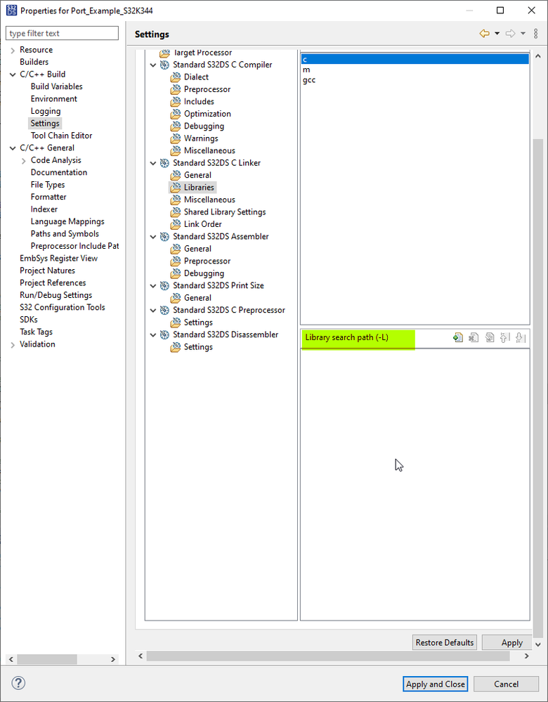

Hello, I want to put the dependent libraries on a network and build the project on my local system.
For example in the image attached, I want to change "HSE_DIR_PATH" from local path of my sytem to a remote path (located on some server like one drive).
It this possible in s32 design studio to provide a network path of library? Please let me know.
3,303件の閲覧回数
jiri_kral
you need to map the network drive into OS - let's say as a drive N: or what you want - https://support.microsoft.com/en-us/windows/map-a-network-drive-in-windows-29ce55d1-34e3-a7e2-4801-1...

Hi, @sanjay645 ,
If the library is accessible by system - there is no problem to use it from network drive.
You would need to add path to library in project properties as shown below:
Please let us know if it works or you have any issue.
Thank you. Best regards.

My question was how to put a network location on path in eclipse as eclipse takes only local path of my laptop but files I want to put on my server, not on my laptop.
