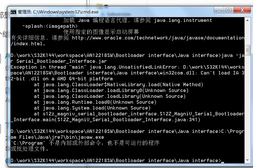

2006070224wmy
Hi,Diana,
I have another problem.In the project,when I install Serial_Bootloader_Interface.jar ,I have a probem.
 Do you have 64-bit PC software?
Carol
4,521件の閲覧回数
ianchu
The solution to your error message is double quotes around the head and tail, which looks like
"C:\program files\java\jre7\bin\javaw.exe"

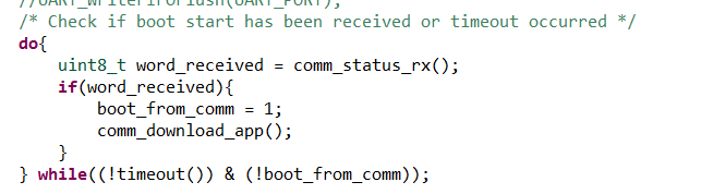

2006070224wmy
Hi,Diana,
Thank you for your reply. I have read the document and the project.
But it need power cuts to upgrade the app without timeout.
And I need to upgrade the app without running out of the power.
