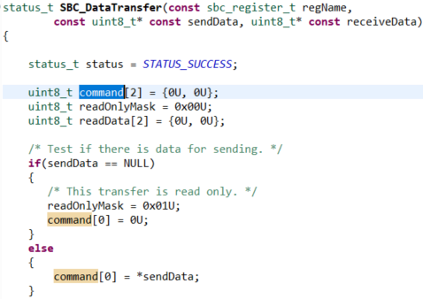

I was looking for an example code for UJA1169 in s32ds and I have found for s32k142evb board.
But I think you should check once the code line which I am sharing line(1627)
while compiling it shows error in Command because it is const,so how in code it is getting modify.
status_t SBC_DataTransfer(const sbc_register_t regName,
const uint8_t* const sendData, uint8_t* const receiveData)
status_t status = STATUS_SUCCESS;
const uint8_t command[2] = {0U, 0U};
uint8_t readOnlyMask = 0x00U;
uint8_t readData[2] = {0U, 0U};

command[0] = 0U;
else
command[0] = *sendData;
/* Address of device with read only bit. */
command[1] = (uint8_t)((SBC_UJA_REG_ADDR_F(regName) | readOnlyMask) & 0xFFU);

Note: if( readData[1] != command[1])
status = SBC_COMM_ERROR;
Due you think readDATA[1] will ever be equal to command[1] because in my case it is always SBC_COMM_ERROR.

Hi Ashish,
Based on your screenshot, there is no "const uint8_t command[2]" inside the DataTransfer function in the K1 SDK 4.0.3 used. Note that during the whole time that the driver was developed (2016-2021) it was never there, so there must have been an error somewhere, I do not know how such a code got into the Design Studio. I suppose it was added there by mistake.
BRs, Tomas
