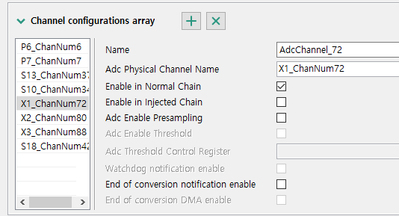

I am currently using S32 Design Studio for S32 Platform 3.4.
The MCU is S32K312, and I am curious about how to set up the ADC channel.
To set up the ADC in S32 Design Studio for ARM Version 2.2,
Just set the Input Channel according to the Name in the Configuration list as shown below.
What screens can I refer to in S32 Design Studio for S32 Platform 3.4?

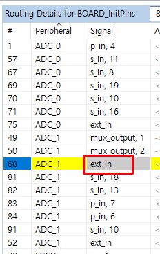

And what information in S32K3xx_RM should ext_in refer to in the ADC setting signal?

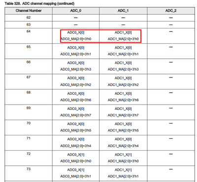

Lastly, I would like to know the meaning of ADC0_X[0] and ADC0_MA[2:0] = 3'h0 in the picture below.
It's a hassle, but please explain in detail.
This pin corresponds to the ADC1_X[1]. You can consult the assignment in the S32K312_IOMUX attached to the S32Ke reference manual.
Meaning of ADC0_X[0] and ADC0_MA[2:0] = 3'h0.
Check the following community thread. It has information related to the topic.
S32K3 ADC Use of external channels
