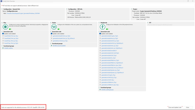

Hi @VaneB,
The development environment is processor = S32K344, IDE = S32 DS V3.5.
In S32 DS config tool window, there is a hint: tools not supported for the selected processor: DCD, IVT, QuadSPI, DDR . As the snapshot (left-bottom corner ) below:
I guess the IVT is used for Image Vector Table configuration.
1,061 Views
VaneB
Hi @kanimozhi_t
These tools are not compatible with the S32K3 family. They can be used on other platforms like S32G.
If you want to configure the IVT, see section 31.5.3 Defining the Image Vector Table Structure of Reference Manual S32K3xx, Rev. 5.
