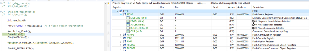

When debugging, the register view in S32 Design Studio does not show any error after the partition command has been  executed. FSTAT_AFTER_PARTITION_FLASH.png

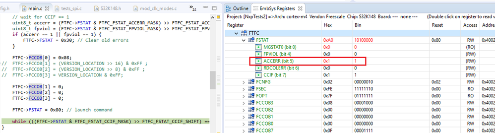

Next step is to erase a flash block using the following code:
void EraseBlock()
 // Erase flash block
 while (((FTFC->FSTAT & FTFC_FSTAT_CCIF_MASK) >> FTFC_FSTAT_CCIF_SHIFT) == 0);
 // wait for CCIF == 1
 uint8_t accerr = (FTFC->FSTAT & FTFC_FSTAT_ACCERR_MASK) >> FTFC_FSTAT_ACCERR_SHIFT;
 uint8_t fpviol = (FTFC->FSTAT & FTFC_FSTAT_FPVIOL_MASK) >> FTFC_FSTAT_FPVIOL_SHIFT;
 if (accerr == 1 || fpviol == 1) {
 FTFC->FSTAT = 0x30; // Clear old errors
 FTFC->FCCOB[0] = 0x08;
 // from my understanding this should be the first flash block
 FTFC->FCCOB[1] = 0;
 FTFC->FCCOB[2] = 0;
 FTFC->FCCOB[3] = 0;
 FTFC->FSTAT = 0x80; // launch command
Howver, right after writing value 0x80 into FTFC->FSTAT, in the register view the access error bit in register FSTAT is set.

danielmartynek
Hello Michael,
As you can see in Section 36.5.11 RM rev.9
When required by the command, address bit 23 selects between program flash memory (=0) and data flash memory (=1).
FTFC->FCCOB[3] = 0x08; // FCCOB0 ERSBLK
FTFC->FCCOB[2] = 0x80; // Flash address [23:16] of 0x1000_0000
FTFC->FCCOB[1] = 0x00; // Flash address [15:8]
FTFC->FCCOB[1] = 0x00; // Flash address [7:0]‍‍‍‍

michael_kirches
Hello Daniel,
I found this comment in the RM, so thank you for this hint.
Your code snippet works for me, only three more questions on that topic:
  1. Line 4 of your snippet should be FTFC->FCCOB[0] = 0x0, correct?
  2. RM section 36.4.4.1.6.4 Fields states "The individual registers that compose the FCCOB data set can be written in any order, but you must provide all needed values, which vary from command to command." But you start to compose the command by writing FCCOB3 first. Is this because of the offsets stated in RM section 36.4.4.1.6.1 Offset ?
  3. Does the command byte always go to FTFC->FCCOB[3]? In the command descriptions the command byte is always mentioned to be written in FCCOB Number 0. This confuses me a bit.
Michael
10,041 Views
danielmartynek
Hello Michael,
1. Sorry, just a typo.
2. It really does not matter.
3. It is FCCOB0 which is offset by 3, that means FTFC->FCCOB[3]. Yes, it is confusing.
BR, Daniel
