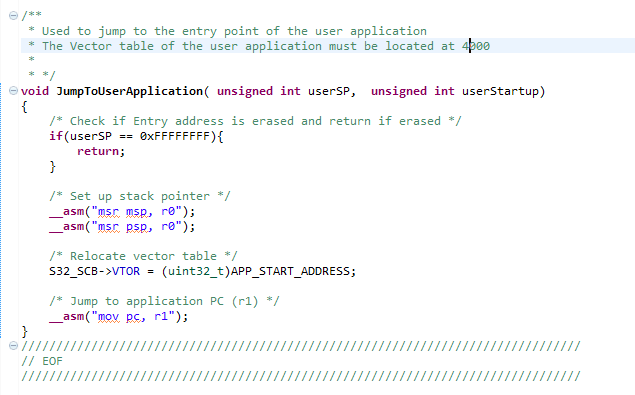

I use the UART Bootloader from the AN12218 example.
I'm using in my application a FreeRTOS. When I do implement only a blinking LED Task, it is working, also with the right frequency.
But it seems like, that no peripheral (UART, SPI, I2C, CAN) is acutally working. For example, when I try to send CAN messages out, when the application is loaded from the bootloader, my CAN device detects only errors.
So for me it seems like, I'm missing something here. Is there something else, that needs to be reset, when switching from the bootloader to the application? Or maybe is my linker file wrong?
The main problem is also, that I do not know how to debug this problem, becuase it only appears, when the application is loaded from the bootloader, when I only download the application (with start address 0x0 in linker file), than the program works perfectly fine.
I hope somebody has an idea.
JumpToApplication function:

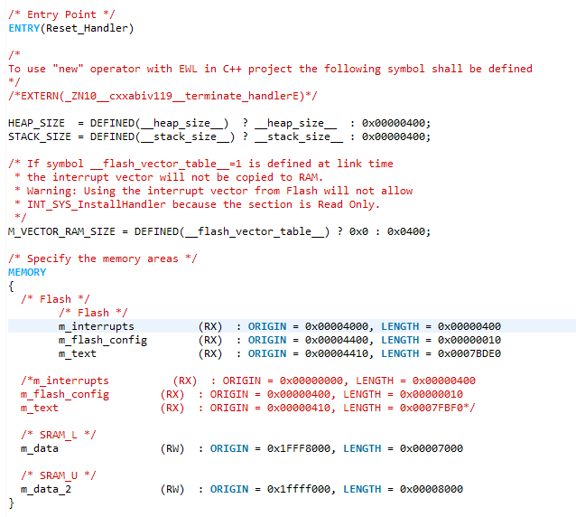

Bootloader Linker file:

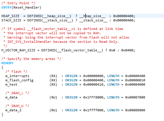

Application linker file:

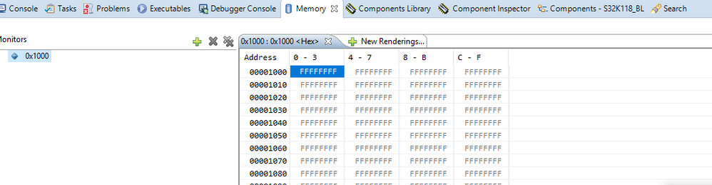

Also, the Memory window in the S32DS can be useful to check the data in the memory.
For example:

Please ignore my suggestion regarding LSB bit ... I haven't test instruction that moves address to PC. I typically saw branching into application  e.g. https://community.nxp.com/thread/451750#comment-908810
Anyway, I'd strongly recommend you to get the MCU into state as close as possible to the after reset values.
I'd focus on peripherals used by bootloader that generate interrupts -> de-initilaize these modules so they cannot invoke an interrupt when the global interrupts are enabled.
Such pending interrupts could execute interrupt handlers that are not used by the application so the execution can ends up in the default interrupt handler or in a fault exception.

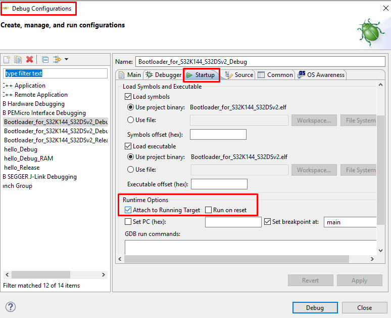

If you 'd like to debug both application and bootloader together please check this document:
https://community.nxp.com/docs/DOC-342385
This will help you to debug the issue.

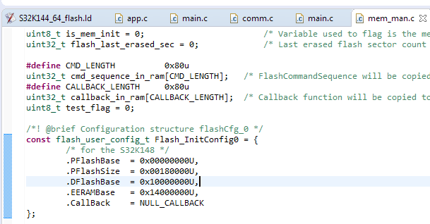

I was able to debug it deeper. Now I think I found the problem:
The bootloader did not write the complete application to the flash.
The bootloader is unable to write data bytes to the flash memory if the adress is greater than 0x13F80.
The FlashProgram function in fsl_flash_driver_c90tfs.c returns always FTFx_ERR_ACCERR for flash adresses greater than 0x13F80... The only thing I found out so far, that the flash Config was made for the S32K148 since the AN12218 project was originally a s32k148 project.
Is this the problem? How can I solve it?
This is the current flash configuration:
I also tried to change, so it will more suit the s32k144, but with no success (I reduced the pflashSize to
0x00080000U)
Does these values matter or is it something else?
Is the memory above 0x13F80 somehow locked?
Thanks for helping
Paul

The Linker files seem to be correct.

Also, you can try to check the registers in S32DS using Attach feature.
This allows you to search the registry even after a reset.
I hope it helps you.

Did you try to look at your register settings by Attach feature in S32DS after the jump?
The interrupts can be disabled by this code: __asm("cpsid i");
