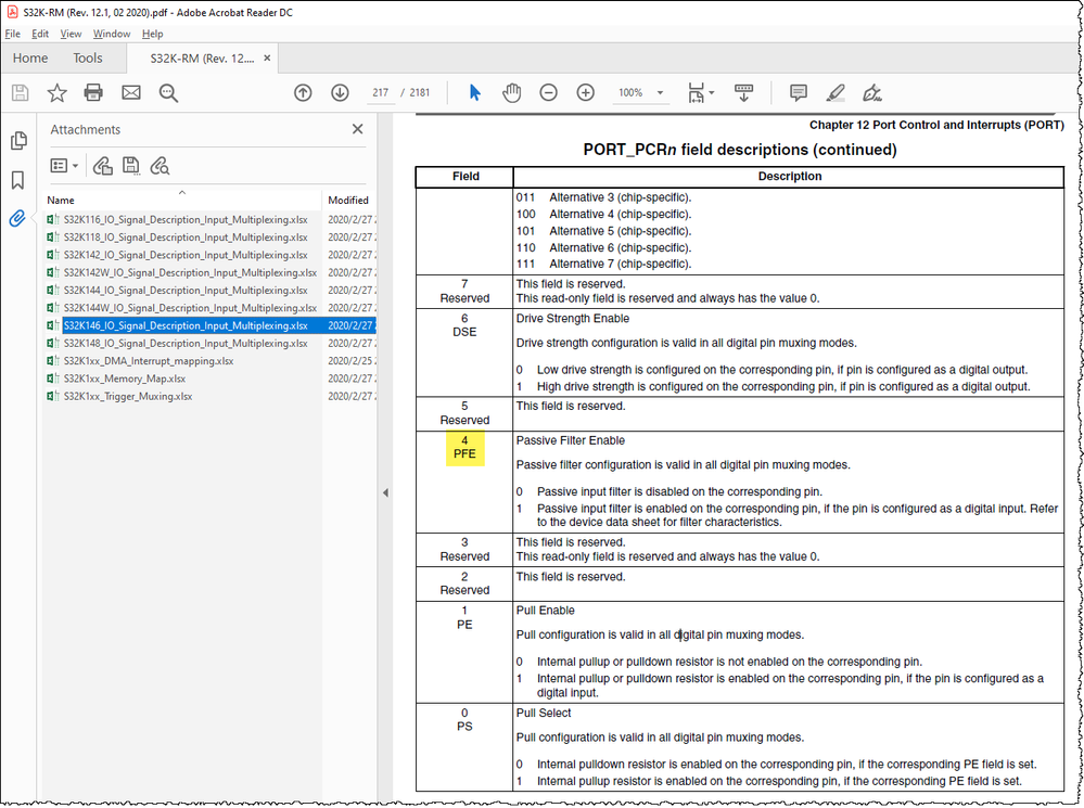

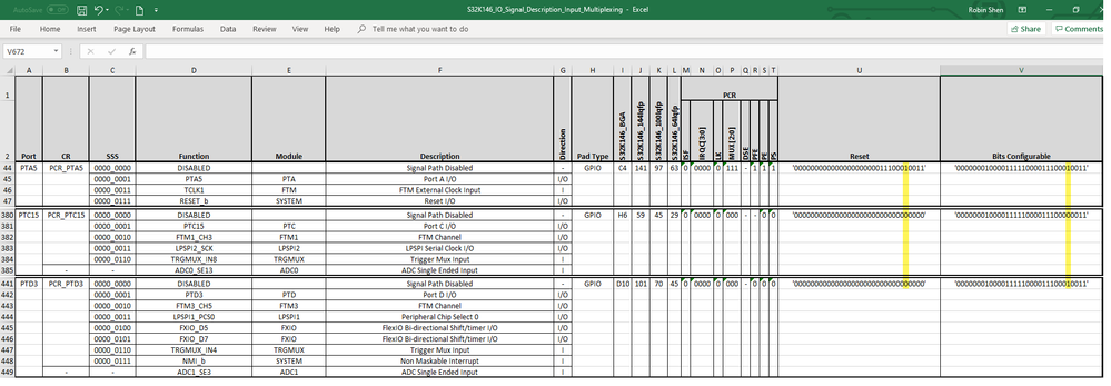

Please refer S32K146_IO_Signal_Description_Input_Multiplexing.xlsx that is attached to the S32K-RM.
In IO Signal Table, column U shows the reset state of PCR_PFE (bit 4) and column V specifies which pin has the PFE bit configurable.
Unfortunately PTC15 does not support this feature.
