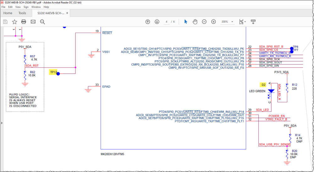

I have noticed if some connections are held high then the dev board will not boot.
J5, pin18 Port D6.
J5 Pin 1 Port A15
J5 Pin 2 Port A16.
Why is this? Is this mentioned somewhere in the data sheet?
When the board does not boot, I see D2 near the SDA chip flashing. If I remove my external circuit then device boots, I add back connections and circuit and micro operate as expected.

I didn't find anything special about these pins. Is there any code related to these pins in the program?
J5 18 PTD6 LIN_RX
J5 1 PTA15
J5 3 PTA16
D2(LED GREEN) is SDA_LED which controlled by K20. Please check the voltage of TP12(SDA_RST) and J9 (P3V3_SDA).

The issue occurs when I have external circuitry powered up, such that A15 or A16 may be high (5v). D6 is high at 3.3v. When I plug the USB cable into the dev board, the S32K processor does not boot at all. D2 LED_GREEN is flashing periodically at about once per second. All other leds are not driven.
This tells me that the SDA micro must be running something in order to flash the LED D2, however I think it is not allowing the S32K144 to boot. The SDA debugger can not be detected in this situation from the NXP S32 design studio. A good starting point would be to explain what the flashing D2 means inside the SDA micro?
I will check the voltages later today.
Regards my program, the application is reading those port pins A15 and A16, and D6 is used as an RX UART. However since the program is not able to boot, I do not believe the issue lies with the application software. Likewise, if I power down my external circuitry, then plug the USB cable in, then power up external circuit, the dev board is working fine - open SDA is working, my application is working e.g. UART, and IO pins A15 and A16.
I hope this clarifies a few points. Will let you know the test points.

I just want to ensure the  bootloader Version and Application Version are ok. Will OpenSDA fail to boot by directly pulling up VDD with external resistors on these pins?
If not, It appears that your external circuit is causing the problem. Have you checked the schematic?
J10 and R63 are DNP, the the VDD is powered by P5V0. Why you connect PTD6 to 3.3v but connect PTA15 and PTA16 to 5v?
