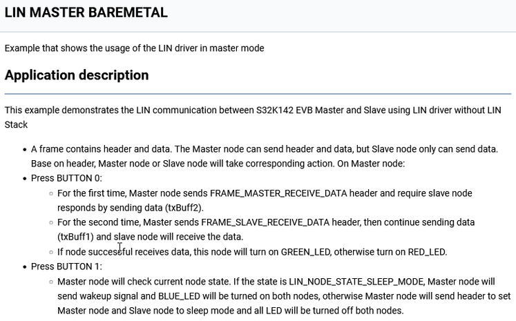

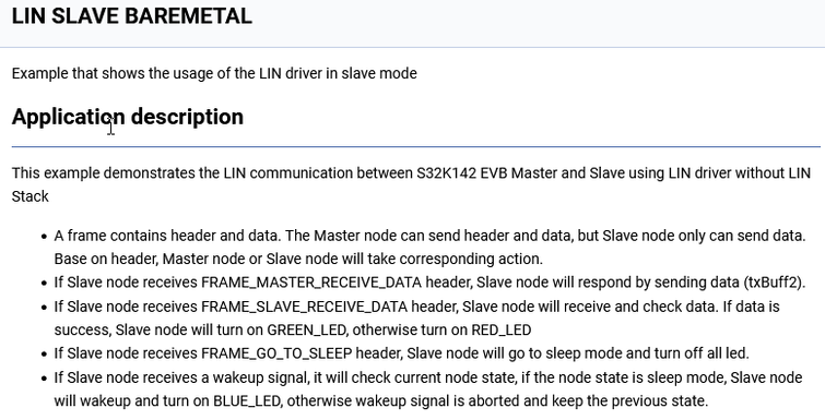

danielmartynek
Hi @sivaEmbitel,
the lin_slave_baremetal_s32k142 example works with the lin_master_baremetal_s32k142 example.
If you have two boards, you can connect them via LIN and communicate.
This is explained in the description of the two examples, please find the description in the S32DS installation directory
For example:
file:///C:/NXP/S32DS.3.4/S32DS/software/S32SDK_S32K1XX_RTM_4.0.2/doc/html_S32K142/lin_master_baremet...
file:///C:/NXP/S32DS.3.4/S32DS/software/S32SDK_S32K1XX_RTM_4.0.2/doc/html_S32K142/lin_slave_baremeta...
