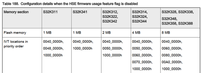

danielmartynek
Hi Dexter,
The SBAF searches for a valid IVT at these addresses only:
What debugger do you use?
