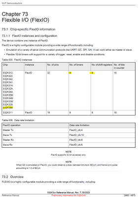

Below is the number of timers and shift registers available on the FlexIO peripheral on the S32K388.  The number of pins that the FlexIO has access to is 32 but it does not represent the number of timers and registers that are available.
John

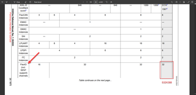

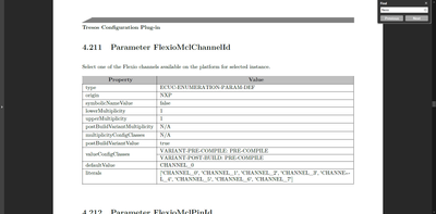

Currently, the driver supports only channels 0 through 7 for FlexIO, even though the reference manual states the 32 FlexIO channels:
The drivers may not encompass the whole limitations of the MCU, for which further implementation must be based on the client's side.
