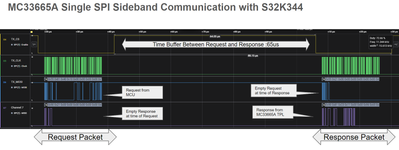

I am working on integrating the RD33774ADSTEVB with the S32K3X4EVB-Q172 via the FRDM665SPIEVB TPL. I need to implement the MC33655A Single SPI mode communication with the microcontroller.
Could someone assist me with the timing diagram for Single SPI communication? The datasheet only provides details for Dual SPI mode.
Additionally, if any hardware customizations are required for Single SPI communication, please let me know.

I couldn’t find a timing diagram as you requested for SPI single mode but, I also couldn't find a timing diagram for SPI dual mode as you mentioned.
The diagram described for Dual SPI is a flow control example to identify the read and response for an specific use case.
For single SPI there is no flow control example. It should work as a general SPI communication and for timing specifications you can check in the Electrical Characteristics.

I tried to communicate with MC33774A AFE via MC33665A TPL in single SPI mode.
MCU Requested UID from TPL and TPL Reponded, please refer to the attached screenshot.
while communicating directly with MC33774A in SPI mode, is it going to follow the same pattern?
Is there a time delay of 65 us, and at the time of the request, the response is empty or vice-versa?

You can get more information about the SPI communication in our Application Note AN13640, that you can find in Secure Files from our website. MC33665A: Isolated Network High Speed Transceiver and CAN FD Gateway | NXP Semiconductors (If you can't access to secure files, you can request the file in the same website)
In the Application Note, you will find specific information about the hardware and software side from SPI communication protocol in MC33665A.
