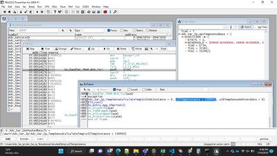

After this its Tca1 its going to the vector catch.
its going to the trap_bus_isr and went to vector catch.

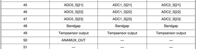

In a configuration what need to be configure related to tempsensor in the ADC Unit in EB tool.
I configured the Tempsense channel in the ADC unit and for this no port pins available(junction temperature) I'm getting the value also for this channel.

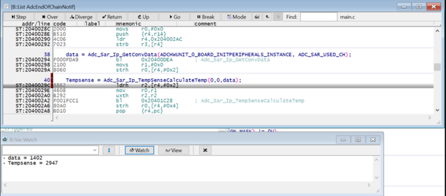

Here are the test results I did based on the demo in the link
What you need to pay attention to is the reference voltage of your ADC module
The Vref I set here is 3.3V, which is 53
9,824 Views

As shown in the test result I provided above, the ADC sampling value is 1402, the converted result is 2947, and the actual temperature is 29.47℃。

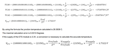

Hi@Senlent
I too geeting the tempesense value.
How you are converting that into temperature.(your getting 2947 in millivolt its 2.3748mV how you calculated into temperature 29.47degree C.)
In reference manual not specified the formula.
I know the formula like (mV - 0.5)*100 for temperature calculation.
Is there any formula is there to convert?
By using the formula the junction temperature calculated like this mentioned.

Senlent
Hi@Venukumar
You can check the routine provided by me, you will find that the function of calculating temperature has been given in the driver provided by RTD
This function is consistent with the calculation formula given in the data sheet

Venu_M
Hi@Senlent

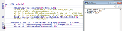

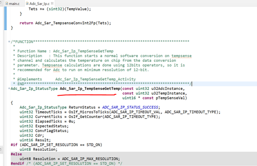

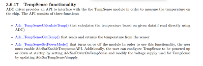

I used that Api().
Adc_Sar_Ip_TempSenseGetTemp() this Api is given  value as 616 , I don't know how to get this into temperature.
Adc_Sar_Ip_TempSenseCalculateTemp() this Api given  value as 569.
Not able to get the temperature in the degrees.
I can use one Api among these 3 Api's, I can get the temperature correct.
For the first one we need ADC sampling data, For the second api no need of any data directly we can call the api and get the temp through the sensor correct?
Third one also we can able to use?
Can you tell me the flow of Api which one i need to call first.
Adc_Sar_Ip_TempSenseEnable(AdcHwUnit_0);
data1 = Adc_Sar_Ip_GetConvData(AdcHwUnit_0, ADC_SAR_USED_CH);
Tempsense =  Adc_Sar_Ip_TempSenseCalculateTemp(AdcHwUnit_0,0,data1);
Adc_Sar_Ip_TempSenseGetTemp(AdcHwUnit_0,0,&temperature);
Adc_Sar_Ip_TempSenseDisable(AdcHwUnit_0);
Like this i called the Api's , whether it is correct?
I'm asking lots of question sorry for that !!!
9,723 Views
Senlent
Hi@Venukumar
Your understanding is correct, but you only need to use one of them.
Also you don't have to call Adc_Sar_Ip_TempSenseEnable/Disable every time.
