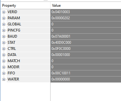

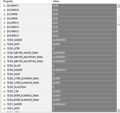

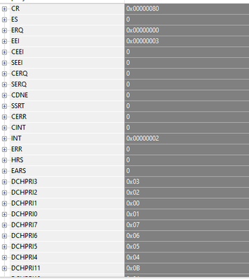

I am using S32K146 and using UART TX and RX with DMA. Its working fine most of time but sometime unable to tx as lpuart0_state.isTxBusy doesn't reset to false. As this is rarely occurring, I am unable to reproduce it for debugging. Below are the configuration for UART. Please let me know how to debug it.

Attaching resisters value during the issue
LPUART_0:
DMA:
