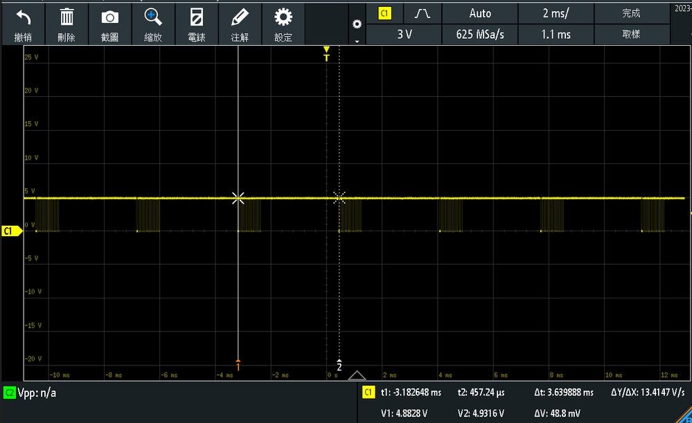

The MCU I am using is s32k116, because I want to do bus-off fast recovery/slow recovery, so I need to turn off the bus-off auto recovery.
My CAN module settings are as follows:

/* Disable auto recovery*/
CAN0->CTRL1 |=(uint32_t)((CAN_CTRL1_BOFFREC_MASK));
CAN0->CTRL1 |=(uint32_t)CAN_CTRL1_BOFFREC(1);
CAN0->CTRL2 |= CAN_CTRL2_BOFFDONEMSK(1);

I set the CAN0->CTRL1 |=(uint32_t)CAN_CTRL1_BOFFREC(1);
However, I found that the setting has no effect, the following picture shows the can tx signal I measured with an oscilloscope. You can see that it still sends out the signal at 3.6ms at the bus off status.
This problem has been bothering me for a long time, please help me to solve this problem.
Thanks.
BT

Hi@wubt01
please have a try below sentence.
CAN0->CTRL1 |= 0x40;
and then check if the rigister CRTL1->BOFFREC is set or not.
1,808 Views
wubt01
Hi @Senlent
The register date from bit 15~0 are "1100 1100 0100 0110" (0xCC, 0x46).
It means  the rigister CRTL1->BOFFREC is set to 1.
Could you please tell me, when a bus off occurs, are there any other register settings that need to be done in the handler?
Thanks.
BT
1,801 Views
Senlent
Hi@wubt01
we have some demo about bus-off test.
https://community.nxp.com/t5/S32K-Knowledge-Base/Example-S32K144-FlexCAN-TX-RX-Error-ISR-test-S32DS2...
You can check whether BOFFREC is 1 in the debugging interface.
When you turn off auto bus-off recovery, you need to manually recover the CAN module after a bus-off event occurs. This is the only difference.
