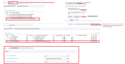

Hello NXP team,
I was connected with NXP Team member SENLENT. He said create a new question with EB as a subject name. Can you share the info with respect to the EB tool.
I tried with this post https://community.nxp.com/t5/S32K-Knowledge-Base/Example-S32K3-Temperature-Sensor-S32-DS-V3-5-RTD-2-...

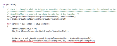

I am getting the value for this on data variable by using Adc_StartGroupConversion () instead of using Adc_Sar_Ip_GetConvData().
For tempsense variable is not updating correctly always its giving 6733(Tca0) value in Tempsense variable so its giving an result as high temperature.
How to read MCU internal temperature sensor value through ADC.
How to configure this pin in the EB_configuration.
which pin need to configured for this.
Adc_Sar_Ip_TempSenseEnable();
Adc_Sar_Ip_GetConvData();
Adc_Sar_Ip_TempSenseCalculateTemp();
These Api i used for accessing the values from the register.

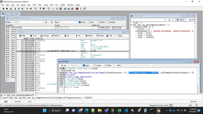

After this its Tca1 its going to the vector catch.
its going to the trap_bus_isr and went to vector catch.
Can you tell me the flow or procedure how to access the temperature value (ETS) from MCU chip by using EB tool.

Hi Venukumar,

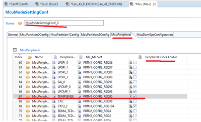

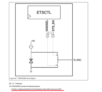

Follow RM:
To enable Tempsense's features, you need to enable these parameters in EB:
To Tempsense output is input of ADC, you need to enable:
Nhi_Nguyen_2-1690945371645.pngNhi_Nguyen_2-1690945371645.pngNhi_Nguyen_3-1690946003512.pngNhi_Nguyen_3-1690946003512.png

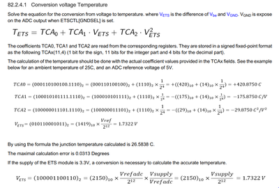

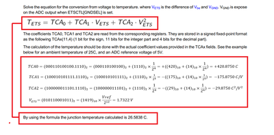

Follow RM, to convert from voltage to temperature:
In this expression, TCA0, TCA1, TCA2 are read-only and normally not change(or change just a little bit) and they have value:
So, in your case TCA0 is correct.
I encountered the issue that temperature couldn't convert correctly for the package RTM201 through the function Adc_TempSenseCalculateTemp(), but this issue fixed in the latest version RTM 300_P07 or fixed early. So, if you're using old version, please upgrade it.
For clock, please don't forget to enable this:

You have to enable clock for TEMPSENSE first, like this:
Please create the new ticket for next time.

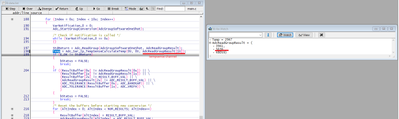

Hi Nhi,
I configured like, what you mentioned.
I'm able to get the value but how i will get the value in a degree based(like 35deg or 56deg)
AdcReadGroupResult_1[8] is the Tempsense channe output(1239).
here i got the value as 3517 by using this Api --> Adc_Sar_Ip_TempSenseGetTemp
Can you please tell me how to convert (api)this value into a degree based.

Nhi_Nguyen
Hi @Venu_M ,
The return value of the function Adc_Sar_Ip_TempSenseCalculateTemp() is in fixed-point format as description below:
Some expressions used to calculate:
For example:
Nhi_Nguyen_2-1696995062041.pngNhi_Nguyen_2-1696995062041.pngNhi_Nguyen_3-1696995151407.pngNhi_Nguyen_3-1696995151407.png

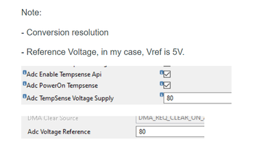

- Conversion resolution
- Reference Voltage, in my case, Vref is 5V.
Seem that there is difference result between expression in RM and driver. I'll contact to SW team and get feedback from them.

I'm getting the value as 1239 from adcgroupresult for the tempsensor channel.
1239*(3.3/4095)=0.9984
So, if i calculate by using this formula, the temperature value will be 200+degree.
How to do this .

From my point of view, your problem can come from setting parameters to measure temperature is incorrect. As I said in the previous comment, please take care these parameters:
Nhi

Reference voltage 3.3v
Conversion resolution 12bit
Parameters is correct only. But while reading the temperature value giving wrong.

Venu_M
Hi Nhi,
I used the same configuration like 5V as reference like you mentioned.
I got the value from ADC is 1059 (last value for the temperature sensor) its varying from 1059 to 1887 like that and its reducing in the low level also,
This Api I'm using.
I'm confusing for this temperature channel value updating.
Can you share the whole process, I did whatever you mentioned but need a clarity for me.
