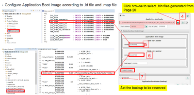

We are working on GoldVIP-RDB2. Yocto for A53 and S32 Development studio for M7. we are facing issue in boot M7 core: IVT tool we are using create DCD/blob image to flash M7 through serial bus UART0. S32 Flash tool we using to flash M7. we observed a difference IVT tool screen and to IVT demo video S32.

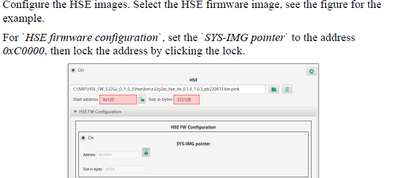

IVT details:
NXP IVT demo video mentioned "entry" screen to give M7 bin file to flash, but S32 design studio IVT tool not showing entry screen.
we given project_code_m7.bin in the application bootloader through serial mode UART0, flashing is success but M7 is not booting. i am doubt Application bootloader is writing in bootrom or else where.
screen is blank after booting.M7 is flashed or stuck etc no information about it.
if SW4: 7th pin is off the A53 is booting.
Is it "entry" screen option do we need to configure in the project settings ??

1. Then in that case our M7 project bin file writing in Bootrom or Application bootloader ?? is my boubt.
And i doubt on the RAM start pointer(0x3400 0000) and RAM entry pointer(0x34000000) from linker file and map
are these address is correct ??? or wrong ?? or do we need to change address in Linker as per our project ??
2. flashing M7 project bin file flashing through Application bootloader column with interface QSPI is it correct ??
    will it goes to NORflash for M7 external memory ??
Please correct me if i am missing any step in the procedure ?? is that address used from linker is it correct ??
Is this is corret ??? or do we need to change linker file ??? this is from Example CAN2CAN project linker file.

RAM start pointer is it correct.??
.intc_vector 0x34501000 0x408 ./Project_Settings/Startup_Code/Vector_Table.o
Please correct me if we are doing anything wrong.

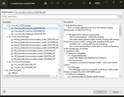

As you are saying, you are running the CAN2CAN project provided on the RTD+LLCE Firmware, which does NOT boot-up the A53 core, meaning you should not see any output from the UART0 regarding Linux.
Q1 >> Then in that case our M7 project bin file writing in Bootrom or Application bootloader ??
A1 >> Your project will not be written on the BootROM of the S32G platform, the BootROM is not available to modifications. The steps of the Boot flow are shown on the Boot chapter on the S32G2 reference manual.

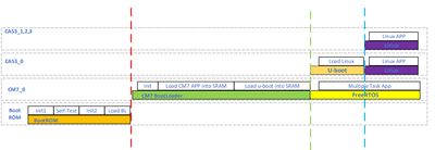

In summary:
  • BootROM will fetch the code provided on the IVT and configure the minimal system for the system to be able to fetch the code and start the application that was copied to internal SRAM.
  • The code provided on the IVT will be your "Application Bootloader", which will be in charge of initializing other cores on the platform (if needed) as well as initialize/configure the needed modules for your specific application.
  • If your application bootloader does not explicitly configure other cores to initialize, they will NOT be initialized.
As for the "RAM Entry pointer", we recommend following the "intc_vector" value (or "Reset_Handler", depending on your application specifics), instead of using the "RAM Start pointer" value, this is following NXP examples. This is shown on the AN13750 (mentioned previously) when creating the application bootloader.

Hi Daniel,
Thank you for reply. Your comments cleared our doubts in flashing.
These address only we are using now : RAM Start pointer is : Sram address(0x34000000) and RAM Entry pointer :(0x34501000 ) INTC_pointer/Reset_verctor address only. Map file and ram_ID file file attached for reference.
Yes : M7 binaries flashed, upon reboot the NO messages on A53 console and M7 is unresponsive with CAN2CAN example project code. Here we blocked.

For Q1, maybe the following comments could bring more insight on the situation over the M7 being boot from the external NOR Flash:
We have run the same code you are working with using the below configurations on the IVT.
The only modifications were adding an infinite loop to the overall activity and a LED being toggled inside the infinite loop.
With this, we can verify that the code is running on the M7_0 core, and we also use PuTTY to show that no information is provided on UART0 regarding Linux booting up (SD card is inserted in the SD card slot).

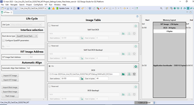

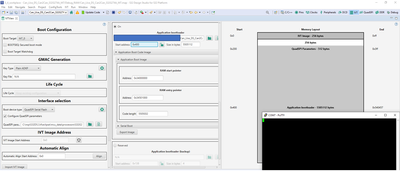

Q1: In our case IVT tool with NOR flash option is formatting SD card also. Now we changed to QSPI and other few parameters added then not erasing.
Q2 : CAN2CAN Sample application bin as goldvip-gateway.bin : We replaced M7 project bin file as goldvip-gateway.bin but RDB2 is not booted.
This question is asked to make M7 flashing process to make easy.
Our details process is below : CAN2CAN sample bin file: interface as QSPI flashing with application bootloader RAM pointer : 0x3400 0000
but still M7 and A53 is not booting but goldvip-gateway.bin is working fine but it is not booting for us.
We are following below configuration in IVT tool to flash CAN2CAN project Bin file. Please correct us if any wrong is there.
CAn2CAN example project.bin with SW4.7 OFF : M7 and A53 is not booting. SW4.7 - ON A53 is only booting and M7 is unresponsive.
1# CAN2CAN Sample project :
2 # Boot Configuration :
3#  Interface Selection :
4# HSE :
5# Automatic Align :

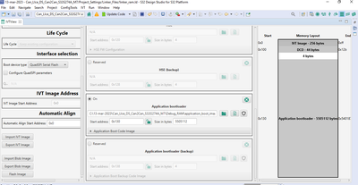

6#  Application Bootloader :  1.  CAN2CAN example project BIN file path given at Application bootloader – Here is my doubt are we are doing right or wrong??.
  1. RAM start pointer is SRAM address : 0x3400 0000.
  2. RAM entry pointer is also same  : 0x3400 0000.
8# : DCD and blob images are exported: Project

We understand that you are using (as a selected example) the CAN2CAN provided project and that you are flashing it with the configured IVT as shown on the different steps/images. This is not working.
We have flashed to NOR Flash using the "RAM Entry pointer" as the intc_vector address and has worked for us. We might recommend doing this change to see if this have a different behavior than the one you are having right now.
Still, have you tried a simpler application (like the one provided on the SW Enablement guide) and has it worked for you? We recommend going for a simple application to understand the flashing flow that the S32G platform has. For the steps that you have provided, those are (for our understanding) specific for what GoldVIP SW has to offer. If you are planning on just flashing a new application, we recommend following the enablement guide.

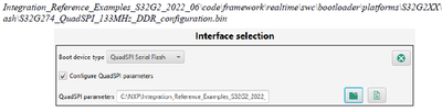

Also, when using the QSPI interface for booting, the following note provided on the RM must be taken into account [Page 1172, S32G2 Reference Manual, Rev. 6, 11/2022]:
"BootROM sets a timeout of 500ms when downloading the application image. User must ensure that the maximum image
size can be downloaded within this time. The image size would depend on the configuration used."
For which a reconfiguration parameters file for the QSPI must be used. There are some available once S32DS and an RTD is installed under the following address (may vary depending on the S32DS/RTD version):
"C:\nxp\S32DS.3.4\eclipse\mcu_data\processors\S32G274A_Rev2\PlatformSDK_S32XX_2022_03\quadspi\default_boot_images"

Thank you for the reply. few documents i went through. We took CAN2CAN example project instead of LEDs project. IVT demo video by NXP we followed in flashing bin file. CM7 project .bin file we are giving in the application bootloader in the IVT, RAM start pointer as 0x34000000  and RAM entry pointer also given same (may be this is the error) after blob and automatic alignment there value is getting corrected here the i have to cross check. Software enablement guide is given RAM entry pointer should be INTC_Pointer address.
In the IVT tool we are choosing:
1. boot configuration M7_0
2. Interface selection is NOR FLASH (after successfully writing it is erasing SD CARD also).
3. Rest of the details are same.
Once POR no messages (May be M7_0 is booted but A53 console(UART0) not giving any message).

I'm having a similar issue : Simple M7 single core application works, flashed OK to the NOR flash, but does not being boot !
Steps I do
1. Building and checking a M7 application from the examples Siul2_Port_ToggleLed_S32G274A_M7
2. Did all steps from: HOWTO: Use IVT Tool To Create A Blob Image S32G274... - NXP Community
3. for the DCD i imported the one from the project, only exported it as binary
4. for the application bootloader RAM entry pointer I put the intc_vector
5. for the application bootloader RAM start pointer I put the int_sram from the linker file
6. I tried either with or without QuadSpi parameters file e.g. mx25_sim200ddr.bin, or mx25_sim133sdr.bin
7. export a blob, looks OK
8. flash the target, it completed OK
9. set the switched to boot from NOR flash, make power off, power on
Result : Nothing!, the LED should have been blinking
what am I missing ?
