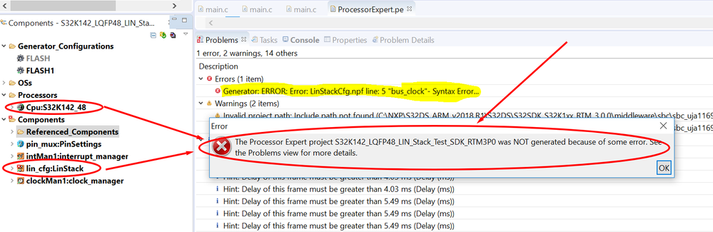

we met an issue of code generation when using the lin_stack component with CPU_S32K142_48 in S32K1xx SDK RTM3.0.0, it promts the following error, while there is no LinStackCfg.npf  in the project:
Description Resource Path Location Type
Generator: ERROR: Error: LinStackCfg.npf line: 5 "bus_clock"- Syntax Error... S32K142_LQFP48_LIN_Stack_Test_SDK_RTM3P0 lin_cfg Processor Expert Problem
PS: we tried the lin_stack component with Cpu_S32K142_100 package, it can generate the configuration codes normally. I attached the test project for your reference.
Can you help to verify and fix the bug?
Thanks~!

Hello Enwei Hu,
The SDK team confirmed that this behavior will be fixed in the next revision of the SDK.
Victor
